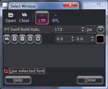

I use the text tool.
There is an editor associated with it that you can type into. Check 'Use editor' in tool options and this will open up.

Help: Gimp Text Editor
