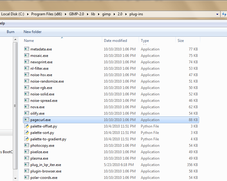

 Post subject: Re: Page curl script
PostPosted: Fri Mar 04, 2011 11:50 pm  (#7)
Posts: 12862
What version of GIMP are you using (32-bit or 64-bit). I'm currently using 32-bit. If you are using 64-bit, maybe the pagecurl plugin never got translated for 64-bit GIMP. :)
PostPosted: Sat Mar 05, 2011 2:00 pm  (#9)
Joined: Feb 06, 2011
Posts: 342
:tyspin :wh
Thanks everyone for the help. I am running 32 bit for sure my pc or OS. My XP is not 64 bit. :) I had downloaded Gimp 2.6.11 last night but I had not installed it until I heard from you guys again. I had to feed the animals and humans first so I just did it now. Yea pagecurl is now there> :yes Again :tyspin
