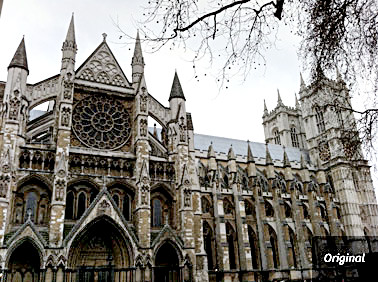

Westminster, simply using Gimp Retinex (default) without further improvements
Hey that looks great and really like Clarity :)

Retinex is a standard Gimp plug-in and has been for a long time. You shouldn't need to install it.
It should appear in the Colours menu (right at the bottom of the list).
If it's not there, check in your Plug-in Browser (Windows > Plug-in Browser) and/or check whether the file is actually installed - if you're using 64-bit Windoze, it should be in C:\Program Files\GIMP 2\lib\gimp\2.0\plug-ins\contrast-retinex.exe

thanks Jonathan, I was preparing to answer the same way, but you did precede me...
standard, very old (2003 I guess), but very effective in situations like the "Cathedral"
