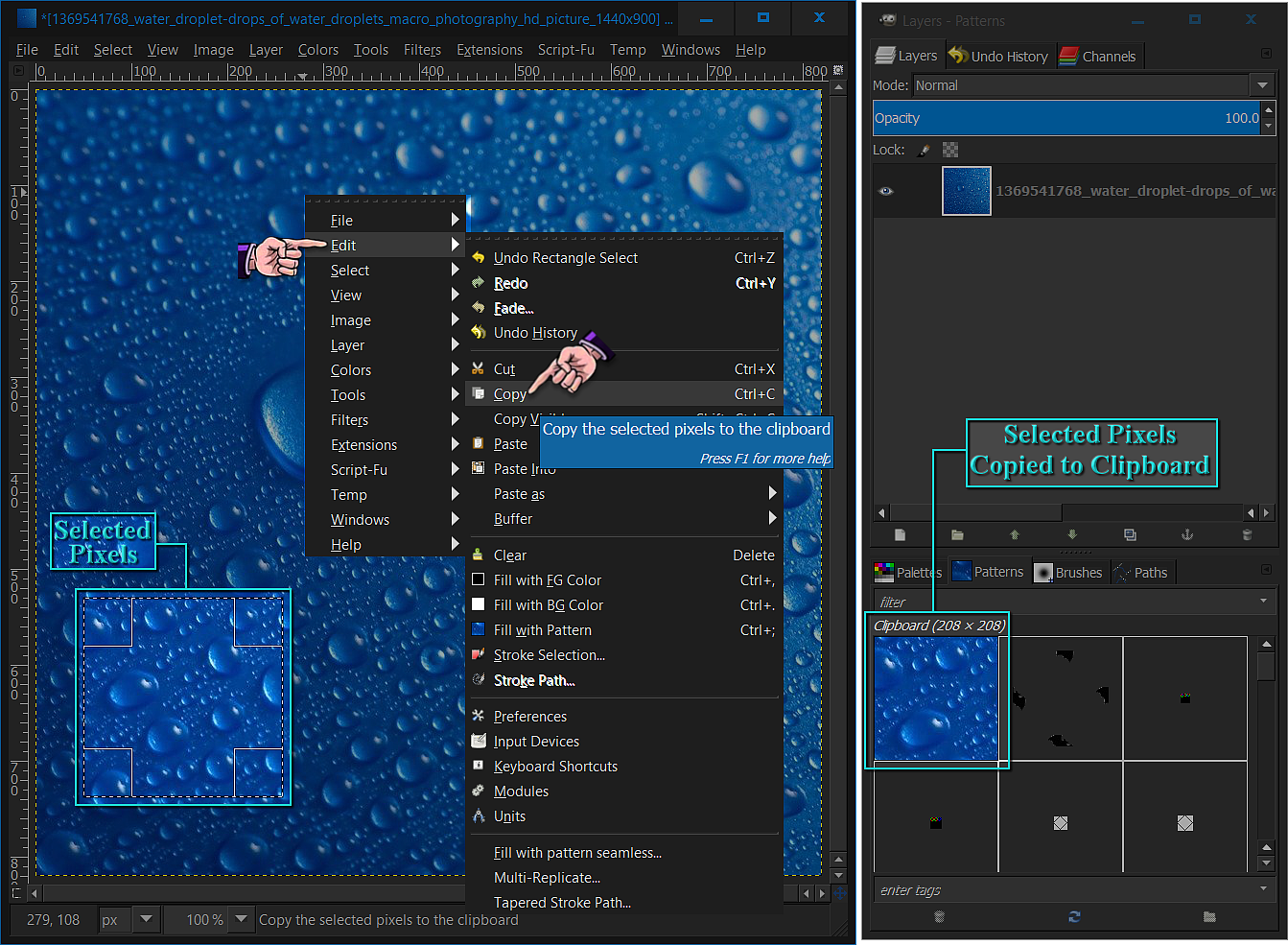

Thanks very much Wallace and Sallyanne. Let me just clarify a little more. So if I'm out looking around, say at textures, and if I think something would make a good pattern on GIMP I can copy the texture (like a portion of it, if so, what size?) to my Clipboard and then add that texture (and name it) as one of my patterns?
If you open any image and use the copy/cut commands.
This will send the copied or cut image or selected region to the Patterns Clipboard as well as the Brushes Clipboard.
Then you can use this copied or cut portion or entire image as a Pattern or Brush form the Clipboard.
This can also be done on the fly for testing out your patterns and or brush, without having to save anything.
Note: If you do not save the copied or selected region as a brush or pattern.
The next time you use the copy/cut command, it will disappear form the clipboard.

Wallace wrote:
The you can use this copied or cut portion or entire image as a Pattern or Brush form the Clipboard.
Thanks Wallace. Great explanation. And I did it. One last question. Is there an ideal size to save as a pattern? I know I can select whatever area I want and I think you had 208X208 so would that be the ideal size?
You're welcome Iggy. :bigthup
I haven't found there to be any real ideal size.
I have many patterns some very large and some that are really tiny.
It all depends on how it's going to be used and the size of the image it's being used on.
As long as the pattern looks right for the image at hand, then it should be alright.
Also, making small patterns larger will cause distortion of the pixels.
It's better to make larger images smaller then it is to make small images larger.
Always try to scale down instead of up, in any situation.
Same goes for patterns and brushes ;) .
