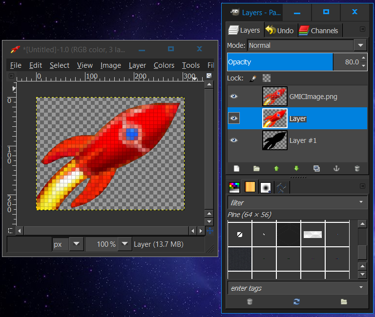

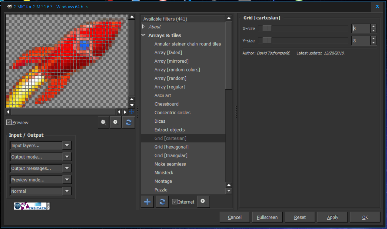

Made this one with G'MIC's, Arrays & Tiles>Grid(cartesian).
The image isn't very clean, but it's pretty close.
I also had to do a little work on it to make it as seen below.
There were a lot of spaces where the grid lines were that needed to be filled.
