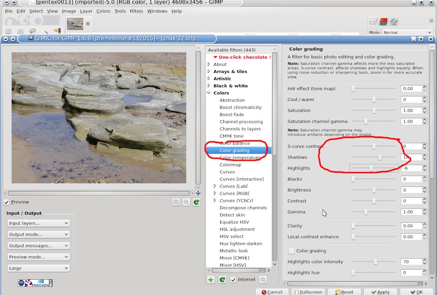

Maybe one of the G'mic plugin filters http://www.gmic.eu
this perhaps

Hi Rich, thanks for your message. I've installed the G'mic filters, they very good. I shall have great fun playing around with them. I tried the filter that you have suggested but, while good, I find it doesn't open up the shadows far enough. Thanks, Ray

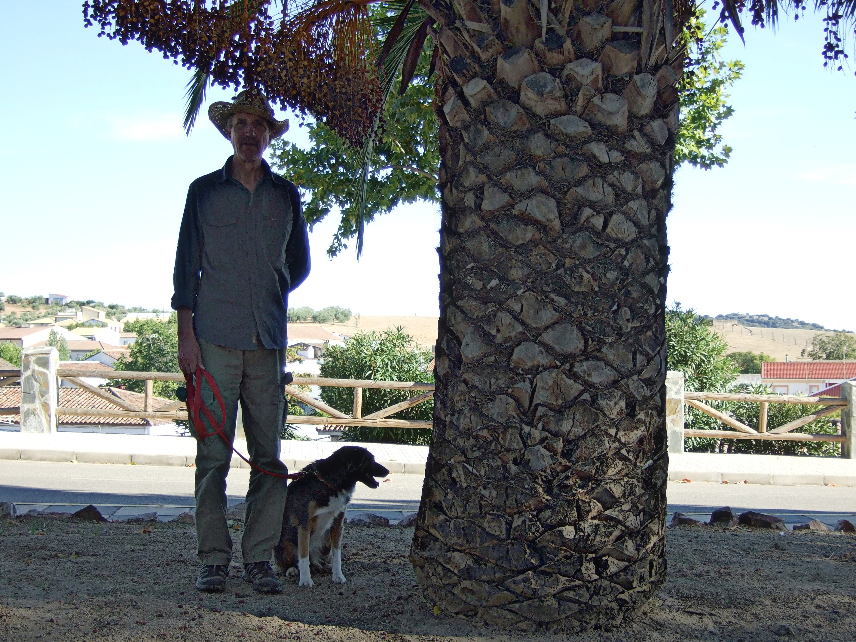

How about I show you an example of a photo I want to work on. You can see the dark area that I want to brighten. Kind of like a fill in flash effect.

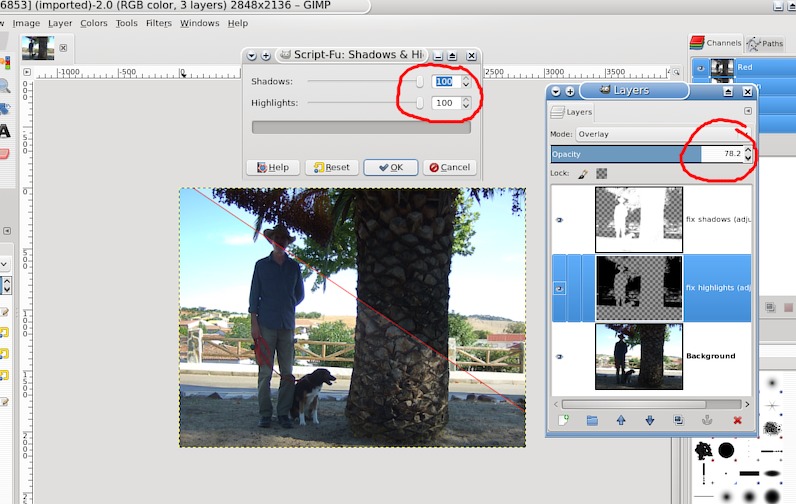

On the basis of OP's first post, a couple of sliders (as in PS filter) and lots of images to process.
Maybe this script. http://registry.gimp.org/node/32369
If all the images are similar to posted then I would just max out the sliders since there is no preview.
A before and after
The masks created are 100% black / white so unlikely to get much better with curves/contrast/levels.
There is some adjustment if the layer opacity is tweaked.
