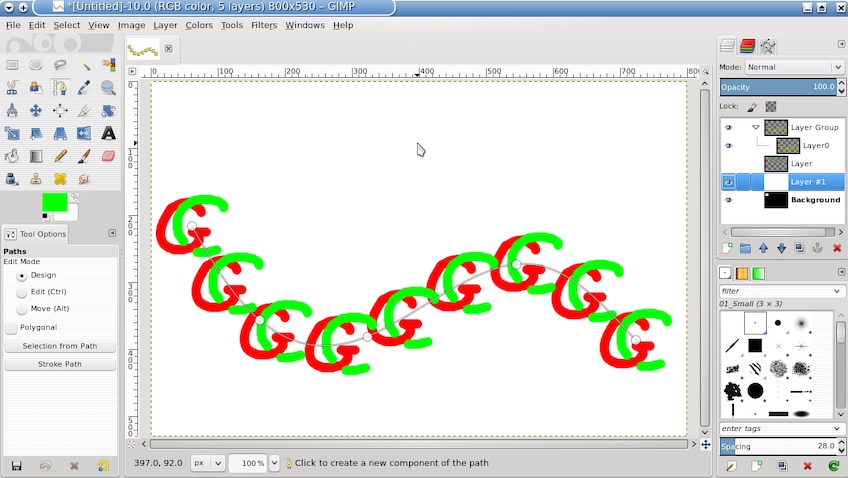

There is a plugin follow-path
http://www.arakne.es/en/dessign/gimp-pl ... llow-path/
a bit of searching and AFAIK this is the most recent version follow-path5
http://www.arakne.es/en/2014/04/ down at the bottom of that page
Dialog looks like this
That is a small 'icon' layer. Draw your path right to left or rotate the 'icon'
With a new white layer under looks like this.

is it capable of "following" also the "curvature" (as Ofnuts filter does)?
(not shown in your example)
 Post subject: Re: brush, image, pattern ALONG A PATH
PostPosted: Tue Dec 01, 2015 7:27 am  (#8)
Posts: 2629
is it capable of "following" also the "curvature" (as Ofnuts filter does)? (not shown in your example)
That is the orientate (orient sic)-on path button - toggle that off.
This might/might not do what you want. Good for small discrete patterns. Do not expect to join a pattern up seamlessly,
