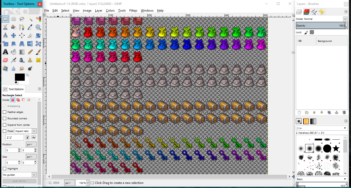

i'm using colorize to change the color of a lot of icon's
each icon will be changed to 36 different color's
i have the lightness at -35 for each icon
i have the saturation at 100 for each icon
now i increase the hue by 10 per each icon
to create a rainbow like effect.
now my question, is their a way for me to copy the setting of the 36 different icon's
and be able to paste that to a different 36 icon's so this way i have less work to do.
or
is their an alternative method to do this?
keep in mind i have to do this for a lot more icon's that are on the same image.
it's an icon set. each icon is 32x32
i'm still really new at this..
File comment: here is a sample on what i'm working on. the keys and pouches are the finished product when the chests and purses are what i need to work on.
