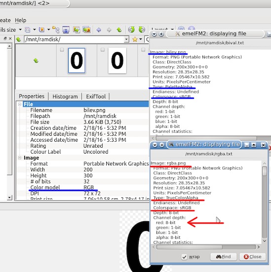

Here is a more visual analysis, Using XnViewMP and IM
Both bival.png and rgba.png are using RGB colorspace. For a bival image you would need to be in grayscale mode.
I can save your xcf to png using default settings and get exactly the same as your bival.png ie. an RGB png.
Adding colour of course makes a differnce, bival.png is PaletteAlpha while rgba.png is TrueColorAlpha and the red channel (colour used) is bumped up to 8 bits.
If you are trying to get a black/transparent png with 8 bits per channel, I know of no way to get that. Tried a few things with IM but always back to 1 bit per color channel + 8 bits alpha (there is anti-aliasing in your image)
Perhaps someone knows how to fake it.
