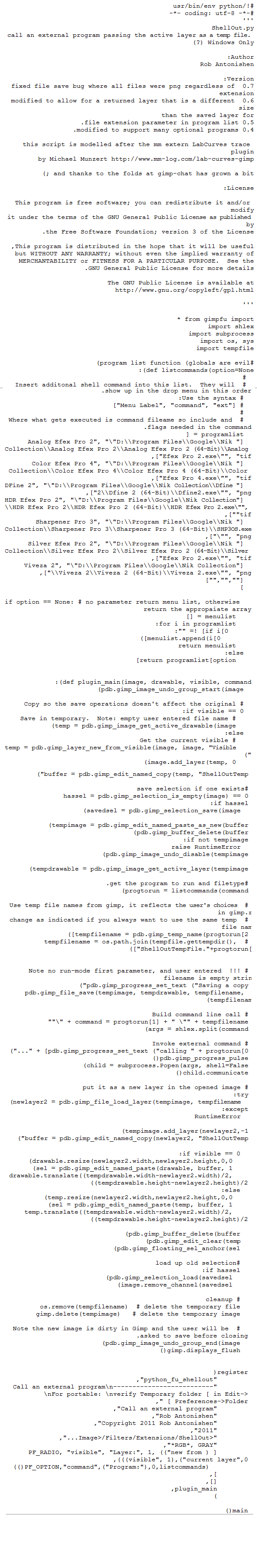

Now the paths that I shared are for 64-bit OS. Not sure if you have a 32-bit or 64-bit OS. Could also been copied wrong. Can you share a screenshot of your shellout file?
 Post subject: Re: [Plugin]Nik Collection - ShellOut doesn't show
PostPosted: Tue Mar 29, 2016 10:04 am  (#20)
Joined: Mar 27, 2016
Posts: 10
My OS is 64bit, the paths are correct (I install the Nik Collection on D:\)
Again, seems the 'calling' of the filter programs are works very well (programs opens)
