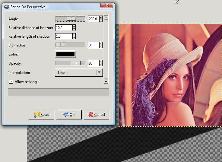

Standard in Gimp: perspective-shadow.scm
Before
  SF-ADJUSTMENT _"Angle"                        '(45 0 180 1 10 1 0)
After
  SF-ADJUSTMENT _"Angle"                        '(45 0 360 1 10 1 0)
Is that it?

I have the impression that the perspective is not correct with the shadow in front of the object:
did the change only extend the rotation without changing the perspective computation ?
(if any, maybe there is no perspective computation, in spite of the filter's name)
 Post subject: Re: Perspective Shadow
PostPosted: Sat Mar 26, 2016 4:28 pm  (#6)
it seems the perspective calculation is there, thus it should be changed also...

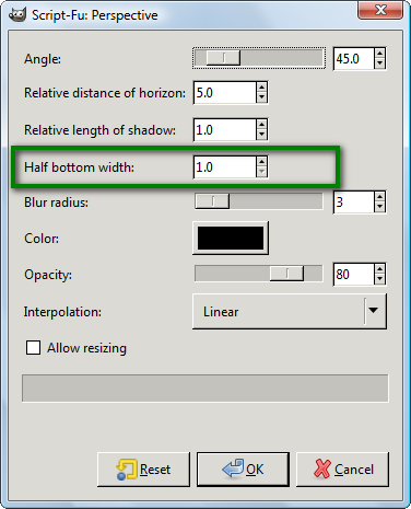

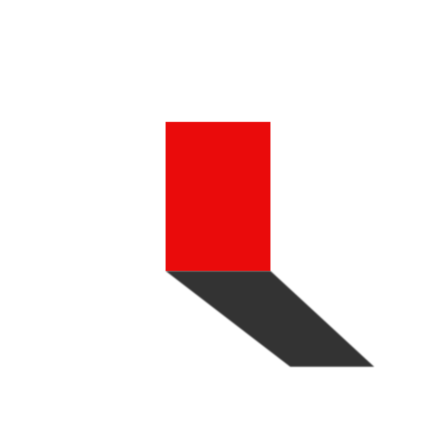

Is this what you want:
Old:
(half-bottom-width (/ select-width 2))
New:
(half-bottom-width (/ select-width 1.5))
Making the number larger makes the shadow come to more of a point. Smaller makes the shadow spread out.
And set at 1.25:

I could not find a way to work it into the script, so I cheated and made a second script. It shows under Perspective2 and is only for 181 degrees through 359 degrees. It shows as Perspective2 under Light and Shadow. Use Perspective for shadows behind and Persective2 for shadows in front.
I have uploaded the file with the corrected header information. Thank you ofnuts

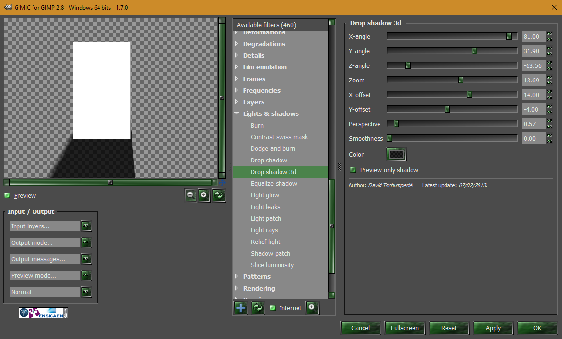

Just fyi, that G'MIC also can do perspective shadow. :)
This does not work the same way. Even with a blank selection, the Perspective shadow will create a shadow based on that selection area, but when I try that with G'Mic, it does not produce anything. Actually, I could not get G'Mic to produce a shadow even with an image selection, using your same settings. :?:
PostPosted: Sun Mar 27, 2016 9:42 pm  (#19)
Posts: 12855
Yeah; and to toy a lot to get it to do this one. :)
