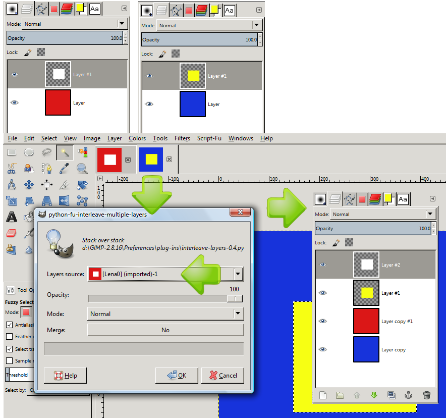

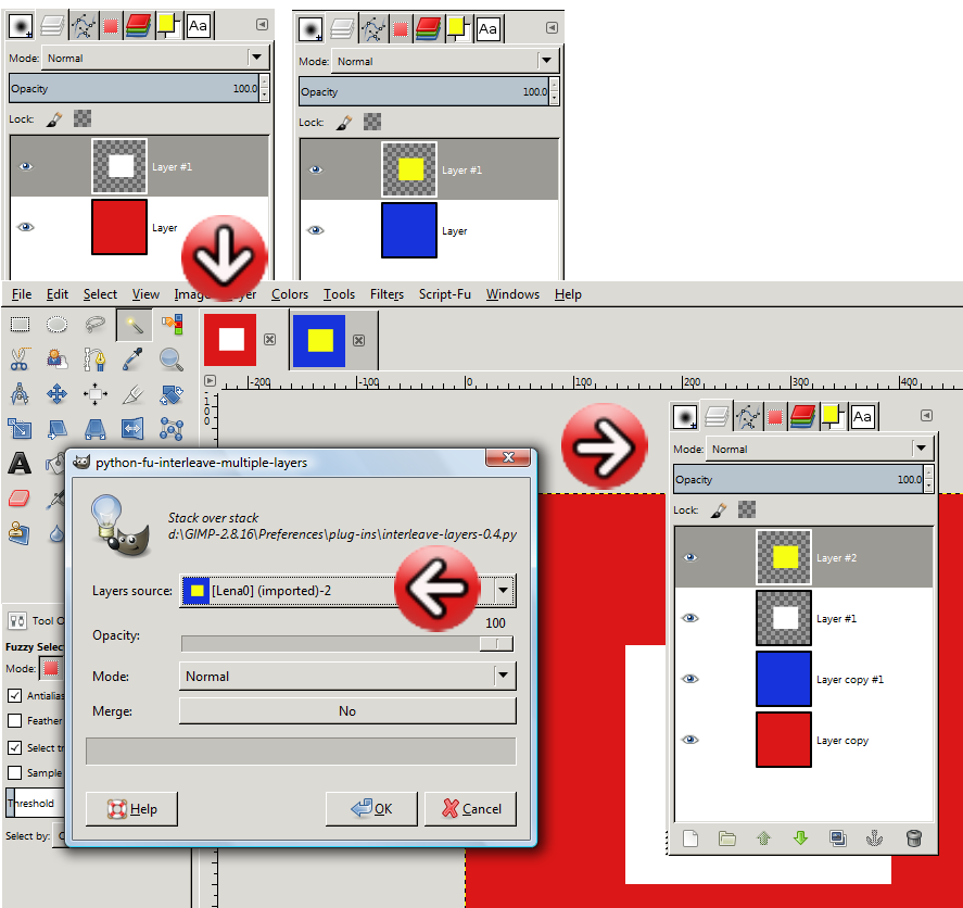

Instead description - two pictures:

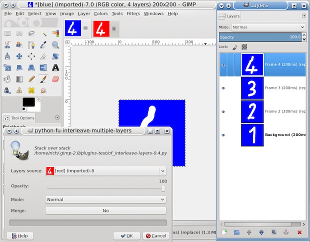

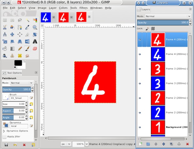

Focus on one image, the other as the source
gives a new image as this
