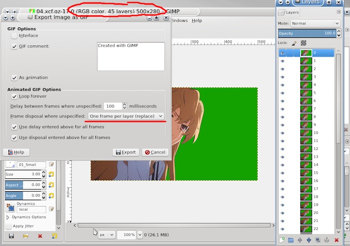

You should have tried for an image in RGB mode with solid layers. Then when all editing finished export as a gif with settings - One frame per layer (replace). That gives a file size of about 3 MB
Once you have that, and if needed, open that gif and Filters -> Animation -> Optimise (for gif) to reduce the file size to about 2 MB. This time use the setting Cumulative Layers (combine)
