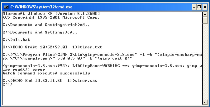

A little better measuring ;)
WinXP about 12 seconds
and in linux, probably a second or two if I ever get round to cleaning up my Gimp profile.
