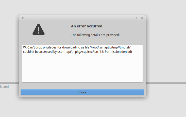

I went to synaptic. It gave me this whiney window (see attachment) but when I went to GIMP I had all kinds of new stuff (FX foundry, Script Kung-Fu etc.) so I'm assuming I have it.
