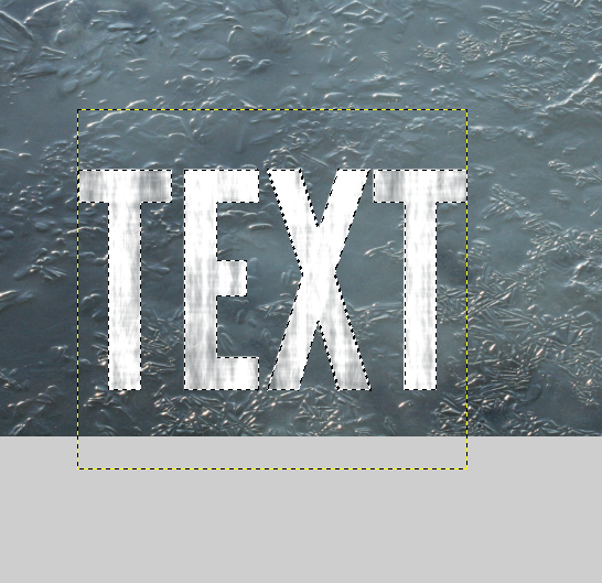

I couldn't get the effect I think has been done. Looks like some of the text has been cut out showing the background.
However I did this which may not be what you are looking for -
Background as you want it. Then text. Then alpha to selection and run G'MIC dirty

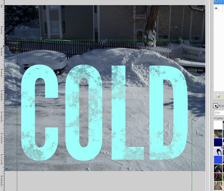

On the text i ran Filters/Render/Clouds/Fog, then i created a selection from the new Clouds layer and cleared the text layer so that pats of the background were visible through the text

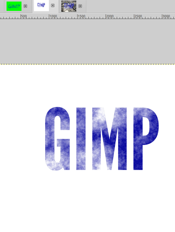

On your text layer:
- Layer>Mask>Add layer mask and initialize to white
- Filters>Render>Clouds>Plasma and use a rather high turbulence
- Use Brightness/Contrast to tune (you likely want more brightness and contrast)(of course other tools can be used for this: Levels, Curves... or even Threshold but it is a bit brutal)

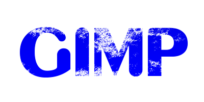

Perhaps just finding a grunge or scratch brush...? I tried a grunge brush (I know I over did it :hehe )
The attachment Graechan-2016-07-19-14-57-17865.xcf is no longer available
Thanks Graechan. Very nice. I had to change the process a bit but I really like the results.

On your text layer:
The attachment ErodedGimp.png is no longer available
Very cool and simple, ofnuts. I tried it.
Hmm. Thanks Dalia. I like the control aspect of using a brush. I'll try it.
