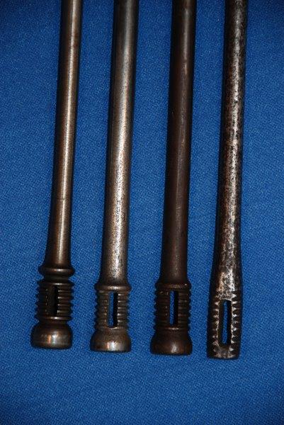

I am editing some photos for a book I'm wrighting. I have placed the subject matter on a blue piece of material and would now like to remove the blue using gimp (and then saving as save as a .png).
I have used 'colour to alpa' but I just cant seem to highlight all the blue with the fuzzy select tool....elements of the blue do work but not all - can anyone suggest how I do this please!!!
Jon

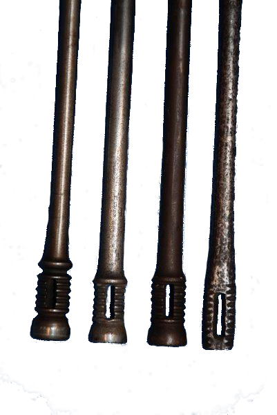

Is this the result you are looking for?
I duplicated the photograph twice, added an alpha channel to the middle layer, then used a selective gaussian blur of 5 pixels on the top layer.
This removed the textile pattern and I was able to select by colour. I made the middle layer active and used Edit/Clear.
With just a small amount of cleaning up with the erase tool it was possible to have a transparent background.
Saved that as a .png.
Having done that you can put any background you require.
I have overlapped with the answer from Odinbc who has probably offered you a much better solution!
david.
Edit: The photograph appears with a white background. However, if you save it to your computer you will find that an image viewer will show a transparent background.

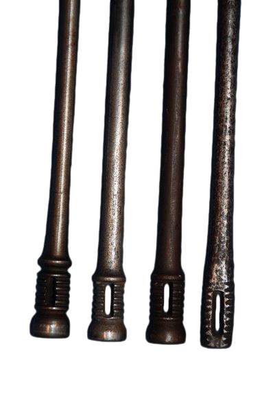

Posts: 14268
This is what I was able to achieve,
using the Layer masking method described by Odinbc.
