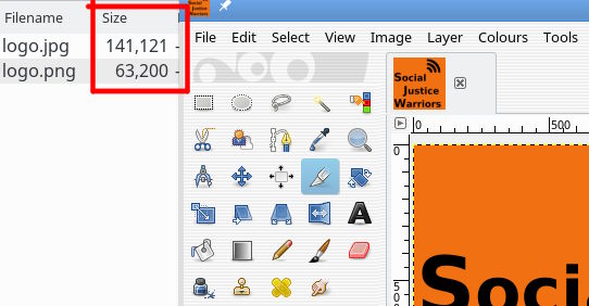

I probably put you on the wrong track. With your logo thumbnail there are only 2 colours.
PNG will compress lots of the same colour very efficiently. If the image has an alpha channel remove it, then a comparison of file size for a 1400 x 1400 px image

Posts: 8500
That's ok rich. I left it as is, saved as a .png. The rss picture has alpha in it because I had to 'colour to alpha' the white out and the 1400 square pic was only 108 kb
Like I said it was very simple. I didn't do any extras on the text or the pic.
Finally worked out the default etc when saving as a jpg but too late he has it online already.
