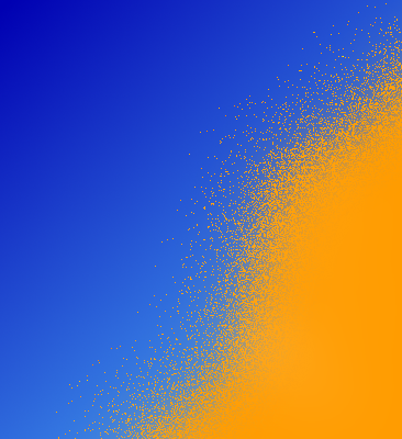

Awhile back I put a couple of layers together that had an interesting result and I liked it.
I think I used the dissolve mode when putting them together but I don't have the XCF or cannot reproduce it. I have cut a small part of the effect out.
The blue area was a smaller layer underneath and the orange I cut a circle out of the middle and put that layer on top. I have tried all the modes without success. Does anyone know how I could have done this?
I think you were right about the layer mode being dissolve.
You would need to use that layer mode and then blur the layer to get this effect.
I would duplicate the layer before blurring and adding the layer mode,
then apply the blur to the bottom copy.
Also,
lowering the blurred layer's opacity kind of spreads out this effect.
Here's an example image.
dissolve.xcf [759.65 KiB]
Downloaded 221 times

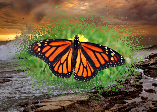

 Post subject: Re: Forgot
PostPosted: Wed Oct 05, 2016 11:59 pm  (#8)
Posts: 4561
Like this sallyanne?
I selected ellipse around butterfly copy and paste that as new layer on top of background.
Layer to Image Size it.
Selected a smaller ellipse around butterfly, Feather with 100 pixels.
Invert selection, Gausian blur with a huge radius like 200 pixels.
Set butterfly layer to dissolve.
PostPosted: Thu Oct 06, 2016 12:41 am  (#9)
Posts: 4561
There's even a better way without having the image blurred at all.
Just select your butterfly, feather it with a large radius.
Paste on top of background. Layer->To New Layer.
Then set to dissolve.
