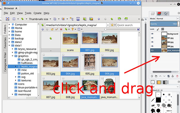

A more hands on approach with Gimp and in this case XnViewMP.
1. Select the files in XnView, drag into the Gimp Window. Traditionally the 'Wilbur' space at the top of the tools is used. Use this if you already have an image open otherwise it opens as layers (see 2)
2. Select the files and drag into layers dialog or the Gimp window.
Snags: Needs an image already open.
Layer size is critial, first becomes default. Might need to use Image -> Fit canvas to layers.

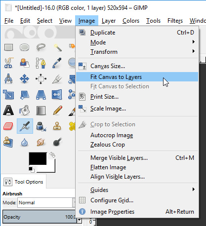

But that gave me an idea to achieve exactly what I wanted! I'll simply use my copy-to function in IrfanView.
When I want images for a same project, I send a copy to a temp directory, when I need just one, I send it to GIMP directly and when I'm done browsing, I just Ctrl+A the images of said temp directory and drop them in GIMP, which will open them as layers in single projects (tabs). It's quick, precise and easy.
If someone knows how to do it via command line arguments though, I'm always listening.
Thank you for the feedback! :D
P.S.: I know it sounds a like a lengthy process, but it's only 2 keyboard taps without leaving full screen viewing. Press F8, then either 1, 2 or 3. Repeat. Drag 'n' drop and Fit canvas to Layers when finished. Voilà!
File comment: Temporary destinations in IrfanView (F8 - Copy file...)
(Which can be assigned a shortcut via GIMP's shortcuts editor)
