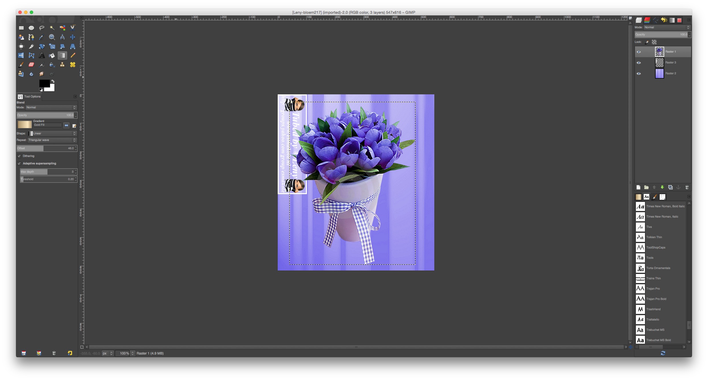

Rich I was unable to open your file but here is one that I opened in gimp just a few minutes ago. it is a purple floral tube
Leny-bloem217.psp.zip [962.99 KiB]
Downloaded 221 times
 Post subject: Re: How to open a PSPimage in GIMP 2.8?
PostPosted: Wed Nov 12, 2014 5:25 pm  (#14)
Joined: Apr 09, 2011
Posts: 1764
here it is in GIMP

PostPosted: Wed Nov 12, 2014 6:44 pm  (#15)
Posts: 14268
akky wrote:
here it is in GIMP
Nice!
All the PSP files I try to open in Gimp give a PSP plugin Error.

Location: US
No problem opening your file in gimp, Akky.
What version of PSP it was created with?

Posts: 1764
It would be most likely PSP x3 or better I think. Its a fairly recent one.
