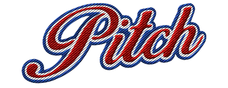

Trying to make an image to look like an arm patch badge see example.
How would i fill selected areas to look like stitching ? I've tried fill with patterns that I've made but can't get the result I'm after.
Any help would be grateful TIA Bob
See attachment of the image i made.

1) Make a pattern with thin stripes (blend tool, repeat with sawtooth or triangle, 2px drag), and perhaps blur it a bit
2) Apply as bump map
(if you start with a bigger image, the stitching will look thinner)

Here's a post by fencepost that describes how to do stitching. You need to scroll down a way to see it.
viewtopic.php?p=119429#p119429

here's my effort.
I drew a blue lines then darker blue lines and darkest blue lines and used it as pattern (copied into clipboard).
Converted your image into 3 colors (indexed mode menu Image->Mode->Indexed) then converted back to RGB.
Selected blue color, Selection to Path. Stroke Path with Paint brush tool but set the brush dynamics to "Track Direction"
Colorized the blue pattern to red-ish color and did the same for Red area.
 Post subject: Re: Stiching
PostPosted: Tue Oct 18, 2016 4:47 pm  (#6)
Posts: 4561
another effort, just added alternating black and white lines and set mode as darken only over red area.
another effort with soft black and white light on red.
another one with added lighting on blue stiches.
here's the .xcf of my play.
stiched_pitch.xcf [922.55 KiB]
Downloaded 142 times

I remembered there was an embroidery script posted a long time ago...maybe this would help your project.Click here.

Hi Bob, you might want to try Filters-Artistic-clothify, I just ran it using default but you can get some good outcomes.

Embroidery Stitcher. Make sure the top layer is in "Screen Mode"

One with a denim pattern on the red color (colorized the denim layer to match).

Rod, you got cool edges going on it looks like thread.
Embroidery Stitcher thats one of Rods scripts :hehe :bigthup
Download from GimpScripts Embroidery-Stitcher

Another method to try... Filters-Artistic-GIMPressionist-paper-canvas2 (duplicate layer x suitable)
