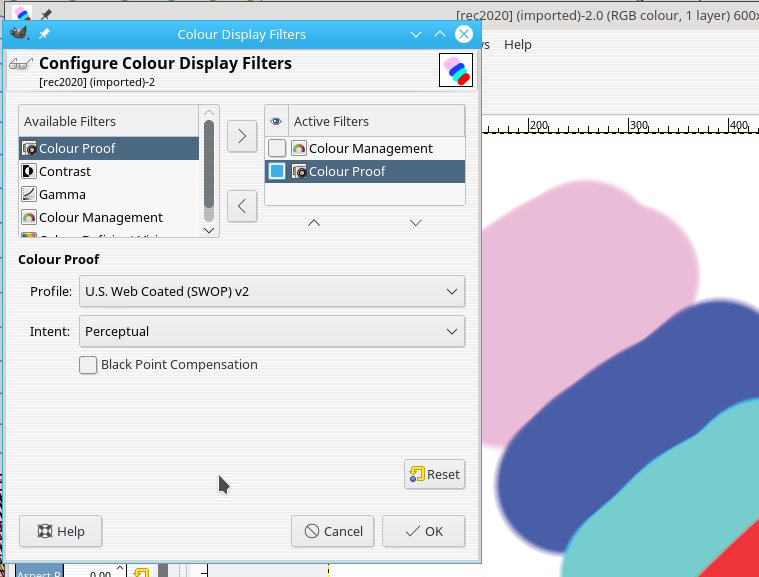

Once you have your monitor/screen calibrated then try the Epson icc in the soft proof section and use
View -> Display Filters which might look like for color-managed
but like this for soft-proof (how it prints, not quite as bright).
