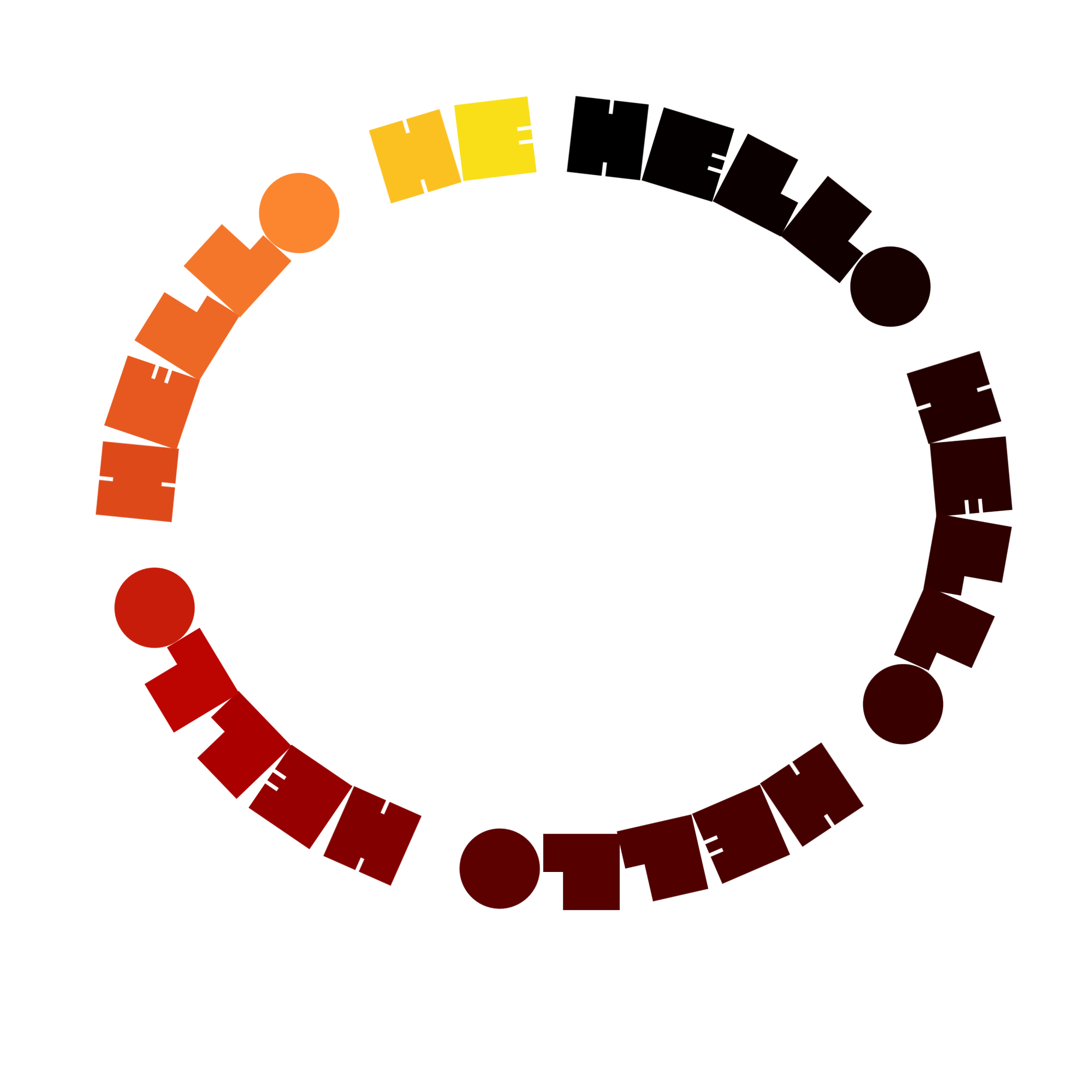

Playing with my next version - to see if repeat along path will work.
Seems to be do-able - in some form at least.
"Hello " entered into the text box and set to auto-repeat.

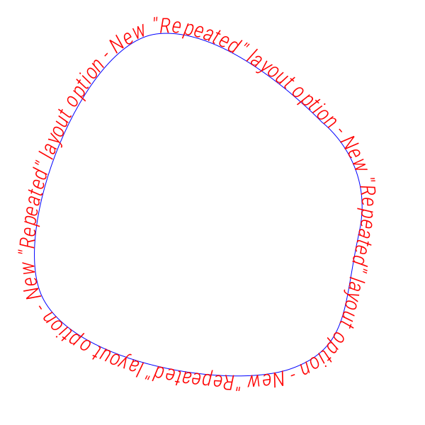

PostPosted: Sun Oct 15, 2017 8:26 am  (#18)

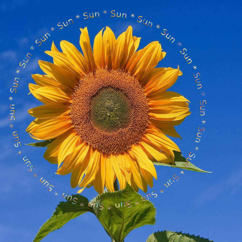

First quick and simple example of use.
