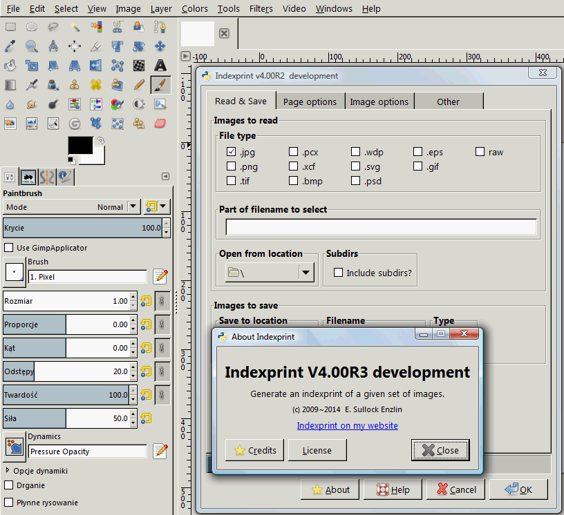

Hi Diego.
It works well for Gimp Win 32bit - 2.8.20 and 2.9.5.
It requires additional libraries:
libglade-2.0-0.dll
libxml2.dll
and iconv.dll (only my requests).

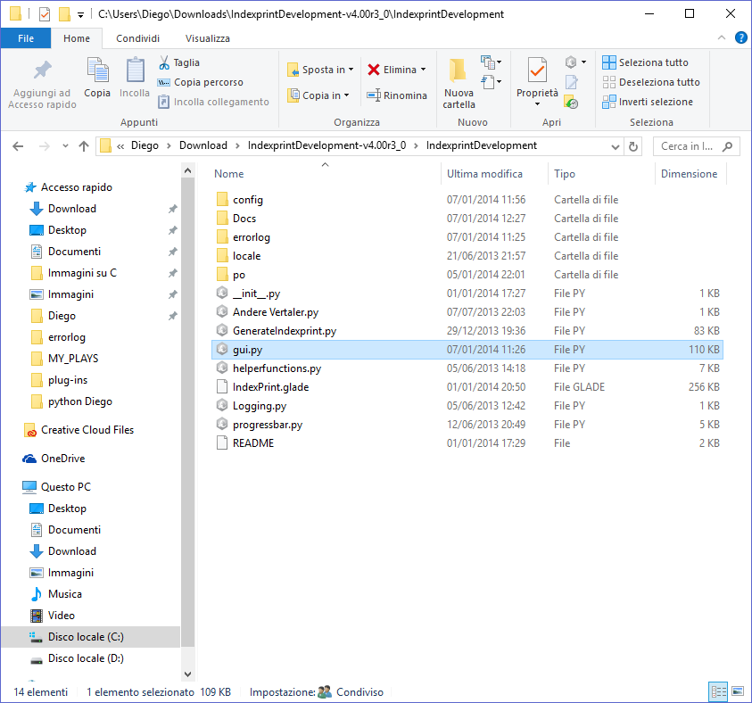

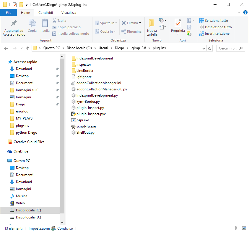

How about a screenshot of where you've put it: C:\Users\Diego\.gimp-2.8\plug-ins\IndexprintDevelopment\ not where you downloaded it to before copying it!

PostPosted: Thu Mar 02, 2017 11:15 am  (#15)
Here it is

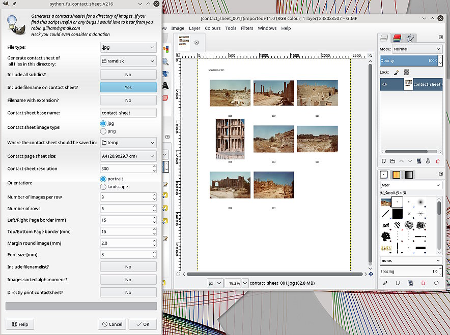

Posts: 2629
@Rashid
Just for info:
The old contactsheet v.2.16 is in the debian package gimp-plugin-registry.deb which you can install via the ubuntu package manager.
Strangely, by mistake, it installs in the scripts folder so I suppose no-one even knows it is there.
Since the package contains a host of scripts and plugins you will never use and even worse they are all in your /usr/lib../share folders, I recommend not installing that but download the deb, unpack and use what is required.
If you want to try this old plugin, it is attached: unzip, pop contactsheet.py into ~/.gimp-2.8/plug-ins check that it is executable. Find it in Filters -> Batch
looks like this in Kubuntu 16.04 64bit, Gimp 2.8.20

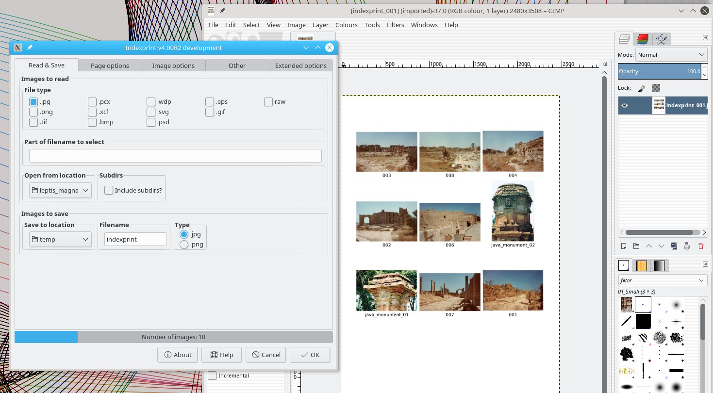

PostPosted: Thu Mar 02, 2017 2:26 pm  (#20)
Posts: 2629
@Rashid
Version 4 works (at least a quick try & seems to) All the installation info is there on the developers web page
http://www.sullockenzlin.demon.nl/Gimp.html
Use your package manager to install
python-gtk2 python-glade2 and python-pyexiv2 plus whatever dependencies they pull in.
One folder from the zip file IndexprintDevelopment and one file IndexprintDevelopment.py go in ~/.gimp-2.8/plug-ins
The plugin registers in File -> Indexprint development. Looks like this in Kubuntu 16.04 64 bit Gimp 2.8.20
