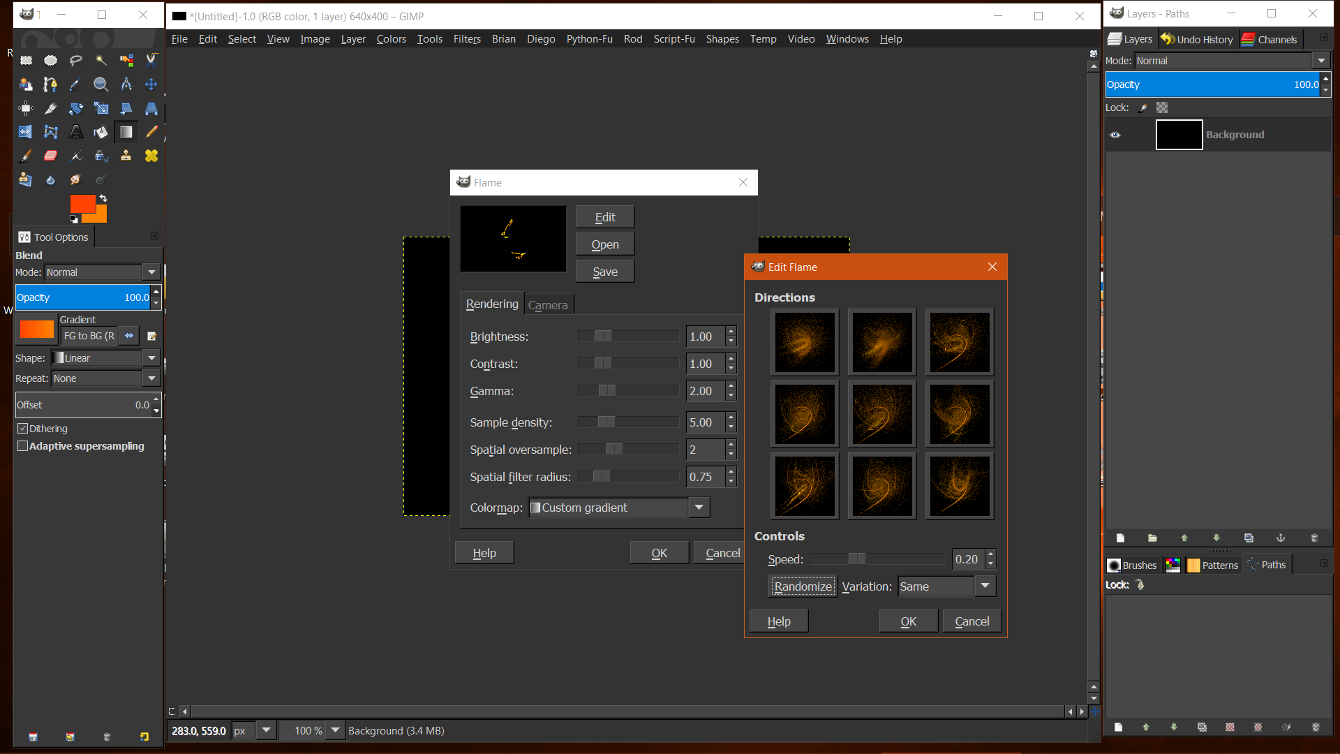

Are you talking about the Flame plug-in.
Located at,
Filters → Render → Nature → Flame,
or something else?
Flame Plug-in Example Screenshot
If it's the Flame plug-in,
have a look at the link below...
viewtopic.php?f=8&t=7502
If not;
let us know what flame script,
or plug-in you're referring to.

Dimensions 3489x4816....I have many layers....
Certainly a problem with that size, almost A3 Very slow but I can get a result.
Try starting with a trial render with the sample density set at minimum 0.1
If that works try increasing a little and see what happens.
