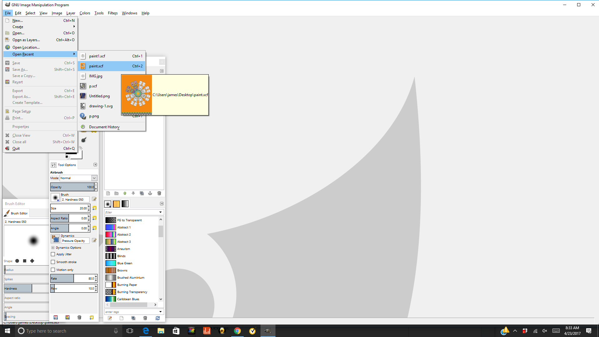

Opening 'C:\Users\james\Desktop\paint.xcf' failed: GIMP XCF image plug-In could not open image
HI,
I was working on a drawing for a while, and all of a sudden I received this message when trying to open it. I'm pretty frustrated. It's strange because when I go to open recent, it shows a picture of the file. The file is in the same location it always was, nothing has changed. Any help would be greatly appreciated. I deleted the program and re-installed it, that didn't work.
Thank You

Depending on what your file is, you could try and share it and see if anyone else can open it. I suspect the file saved incompletely. The image shows in Gimp's recent list, because image thumbnails are cached and saved for quick access. If you go into document history and select the refresh button, it rebuilds the previews. Holding shift while selecting the refresh button rebuilds all the previews and holding Control while selecting refresh eliminates orphaned files.

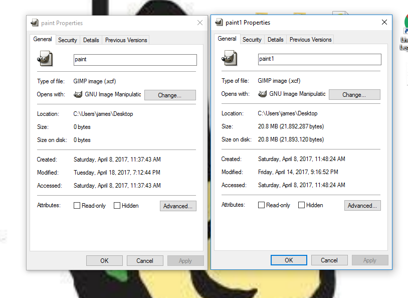

What is its size (in bytes). And what would be its expected size in pixels?
 Post subject: Re: Error -----GIMP XCF image plug-In could not open image
PostPosted: Sat Apr 29, 2017 2:51 pm  (#14)
Joined: Apr 23, 2017
Posts: 5
zero byte image= not working
good call that has to be the reason right? But what happend?
PostPosted: Sat Apr 29, 2017 3:16 pm  (#15)
I have no explanation. If your disk is healthy (see SMART data) and the file system is clean, you could report a bug. I wonder if this could be due to two concurrent file save if you hit Ctrl-S twice, the scoend tile while the file is till being saved. Personally I have never experienced this and it seems to happen only to Windows users (but then there could be a bias since they are the vast majority of Gimp users).
