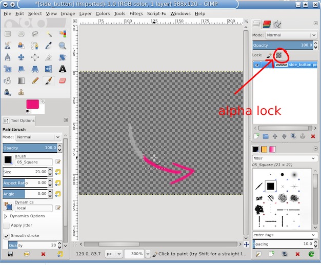

one way
Set the FG colour
Enable the alpha lock
Paint over the arrow.
But then it comes down to saving format, your resulting jpeg does not look great because of jpeg artifacts. Try saving as a png.
