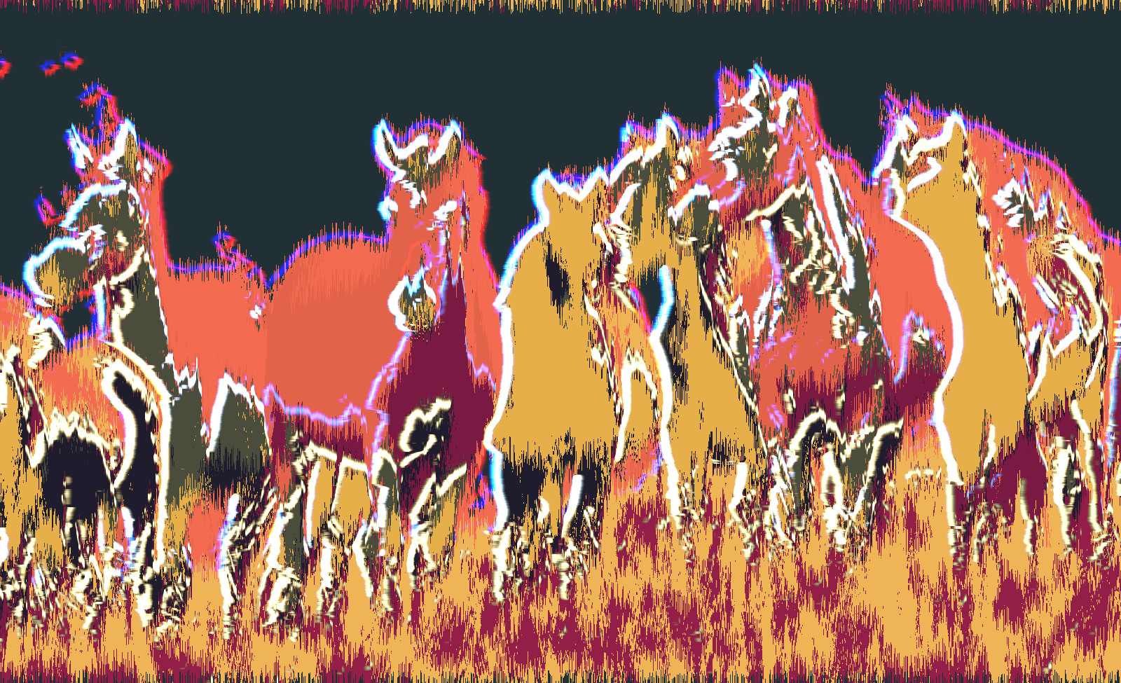

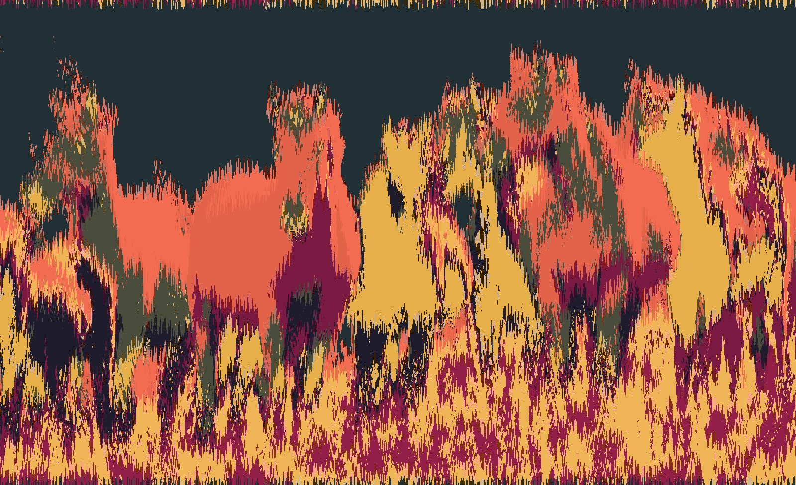

some manipulation
If you want to try there were 4 steps:
1) posterize 4 colours
2) saturate
3) heavy vertical shift (25, I think)
4) gradient map with a strong colours mix

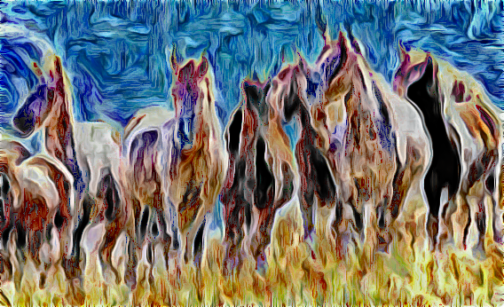

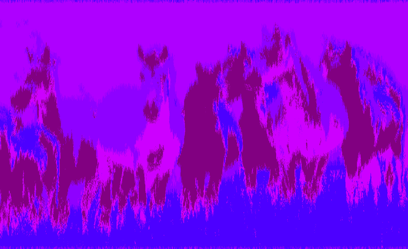

Just repeated my previous trial with different # of colours and gradient

...and adding huge contours

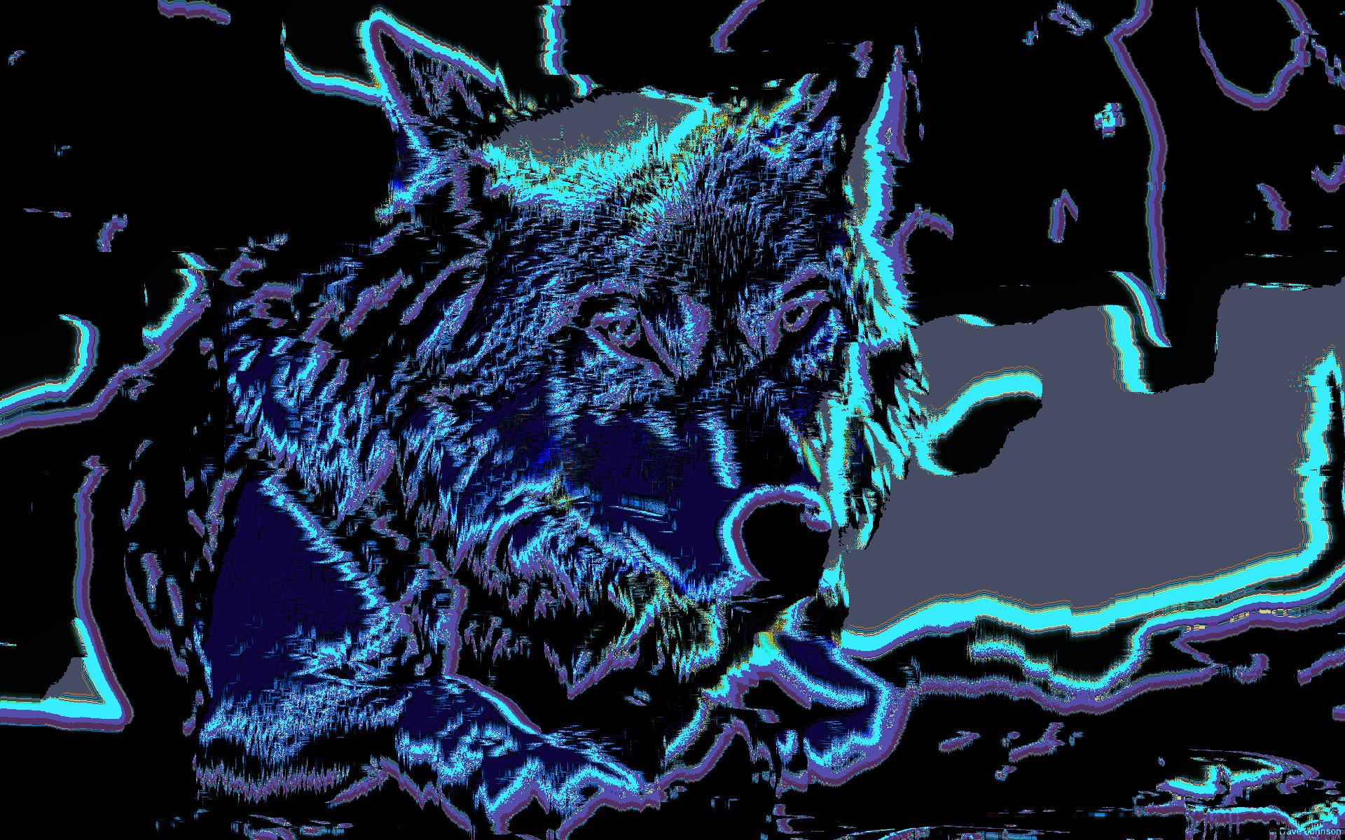

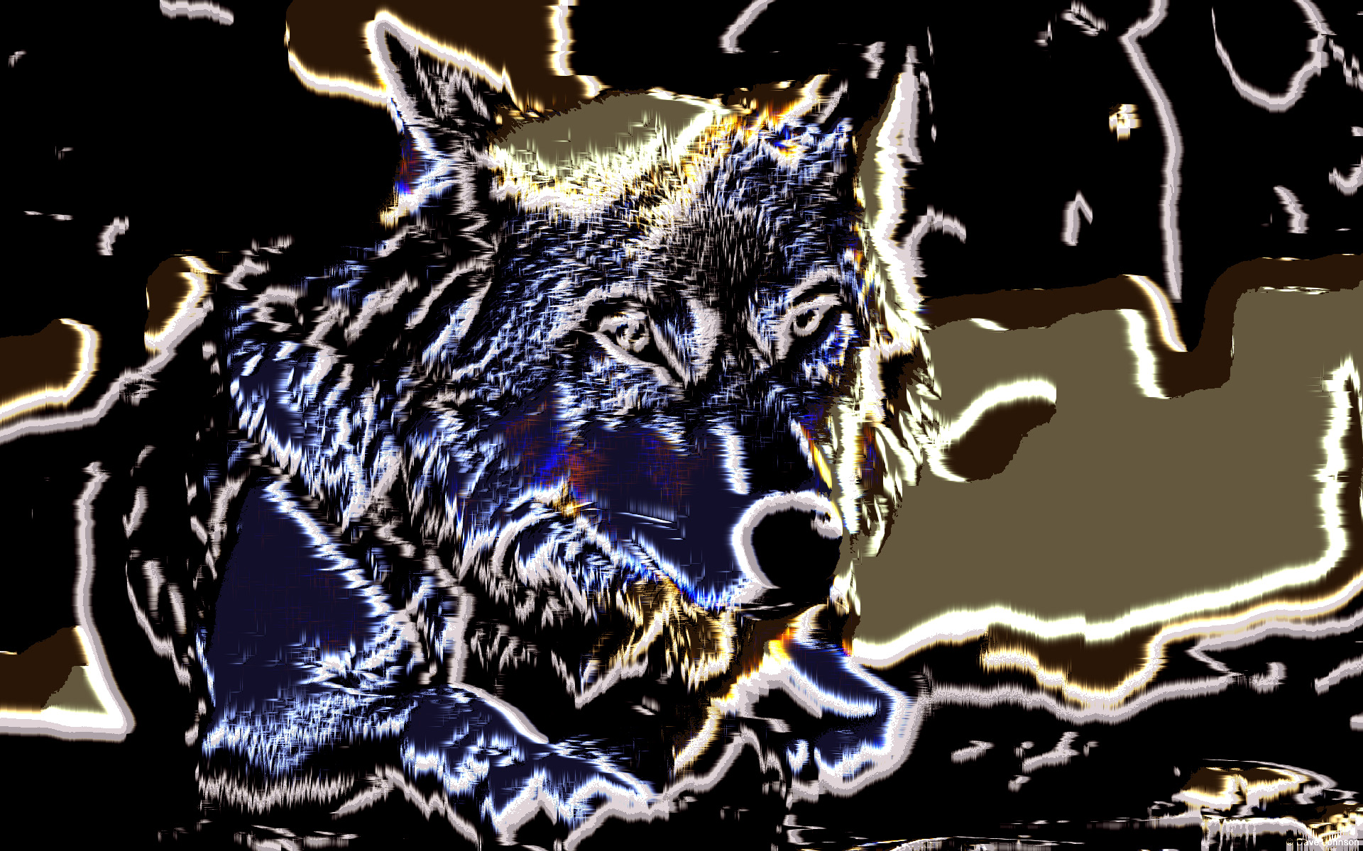

Even simpler and quicker (different outlook).
- posterize 5
- dup layer and apply a huge (neon) edge
- set mode to grain merge
original
outcome

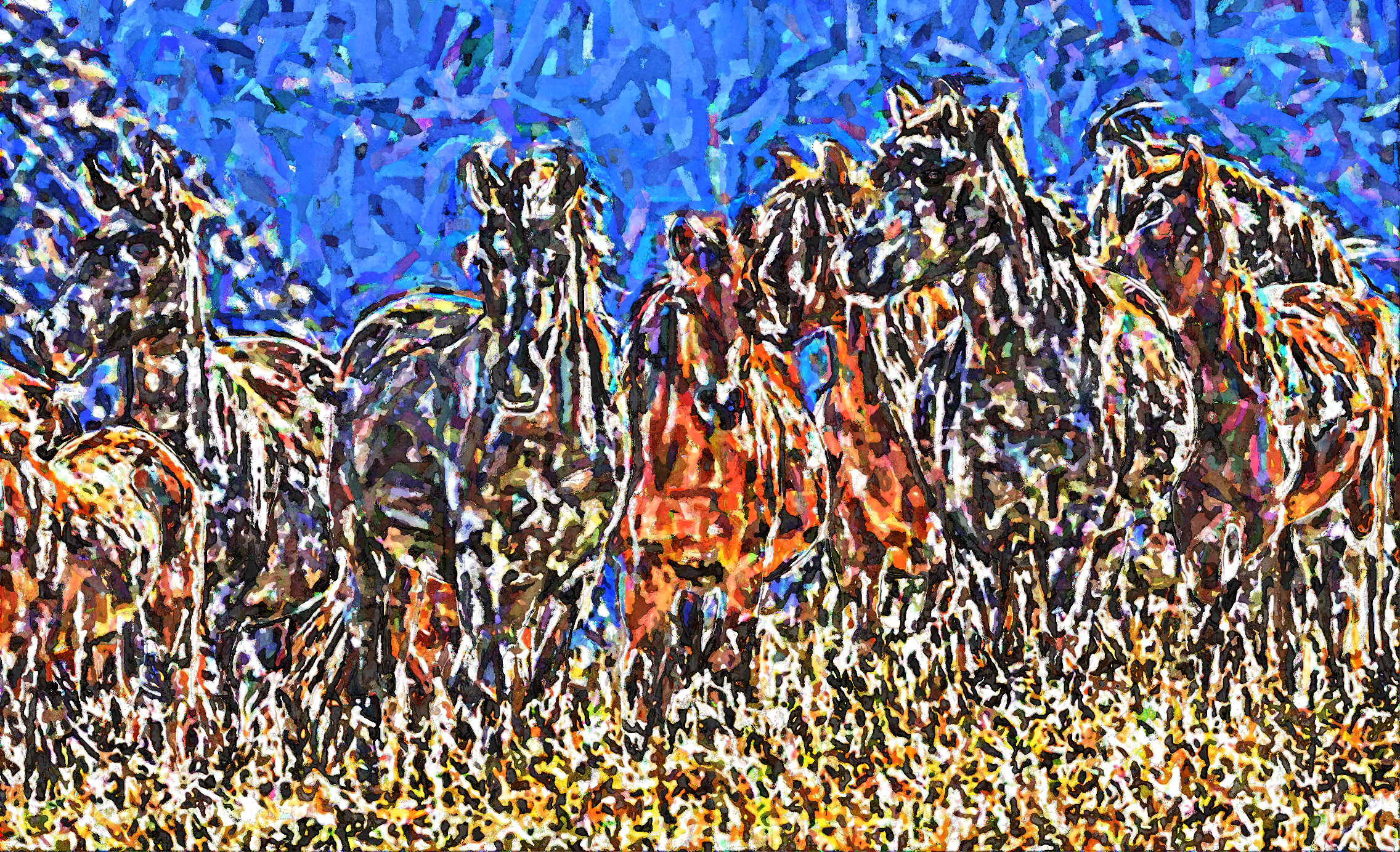

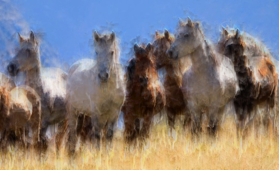

If you are willing to cheat (Impressionist and FotoSketcher in the mix), then a lot of things are possible. Used Diego's horse capture for this abstract. :)
