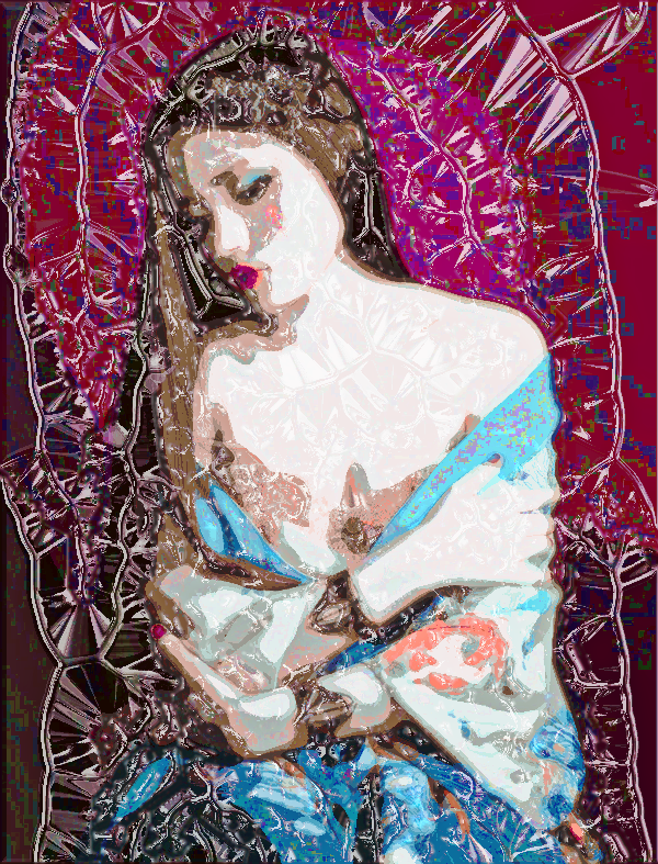

this is an image processed by crystallizeSE

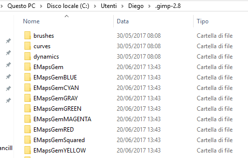

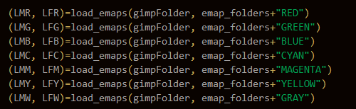

The maps should be located under your gimp-2.8 folder (one parameter of the filter) and the names should be EMapgGem (a second parameter) followed by the suffix defining the color.
Look at the attachments
snapshot of where they are placed in my system
snapshot of the statements which calls the load subroutine, for the 7 colours

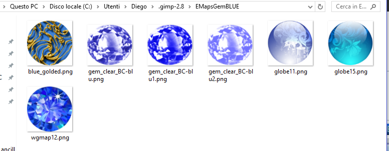

...and the maps are images in png
example for the BLUE ones

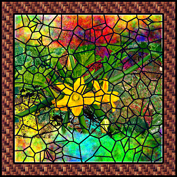

I just got the stained glass script and Love it! Thank you so much, Dinasset!

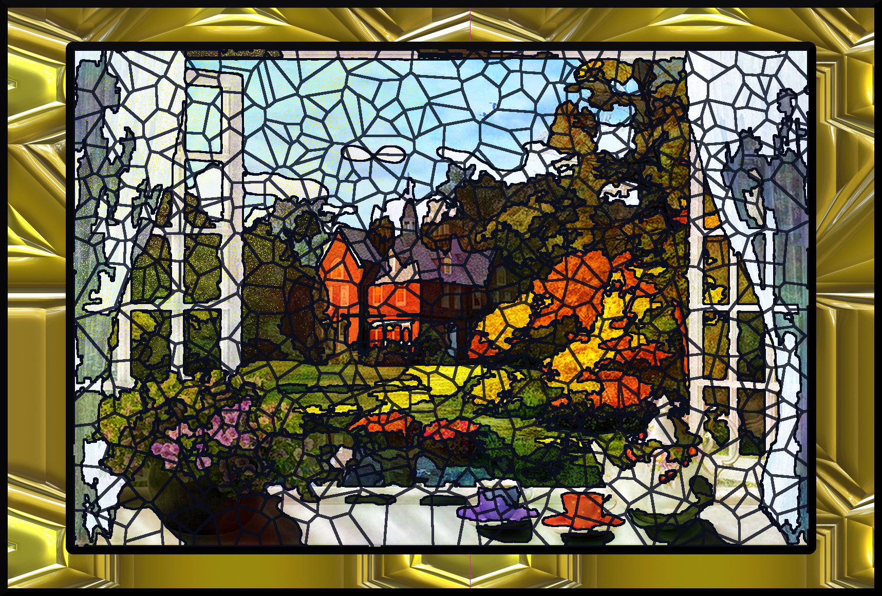

Yes, this version works great! Thank you Dinasset. :tyspin :coolthup
