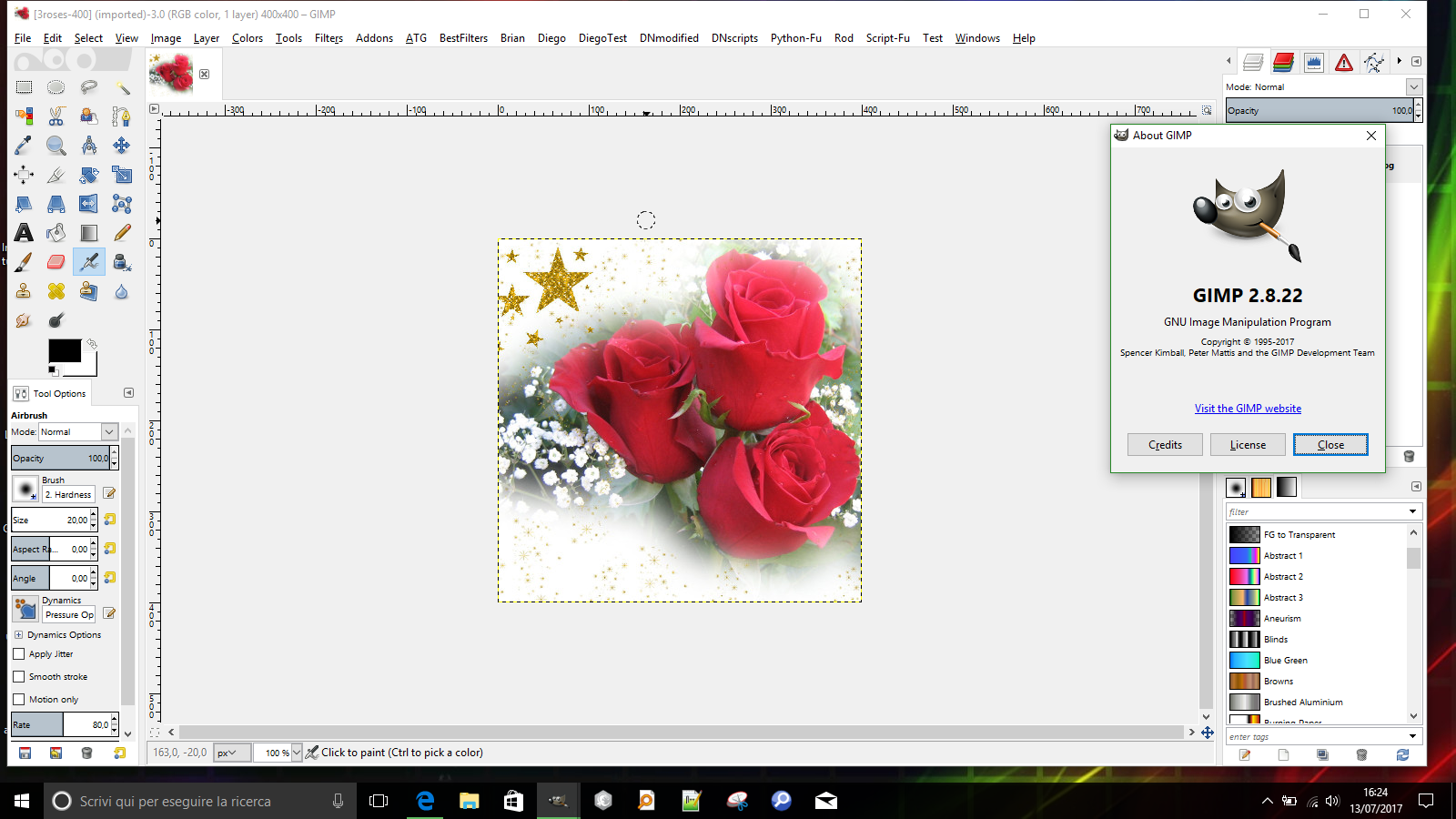

Just downloaded 2.8.22.
No problems opening .jpg images
Screenshot attached
