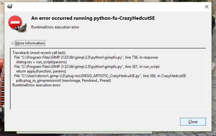

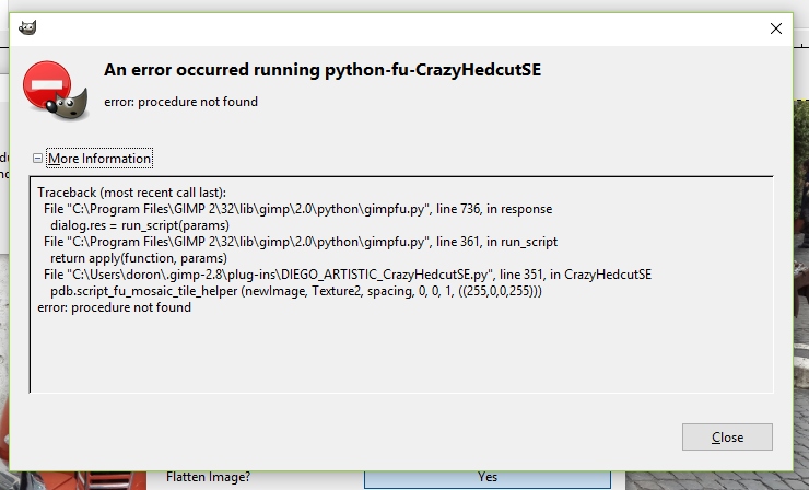

I have an Error when I run CrazyHedCut Effect.
I add 2 photos.
So I need your help
Thanks
Doron.
 Post subject: Re: Error when I run CrazyHedCut Effect.
PostPosted: Fri Nov 24, 2017 6:29 am  (#2)
This script is required:
mosaic-tile-helper(Rod).zip [2.06 KiB]
Downloaded 109 times
unzip and make it accessible in your gimp

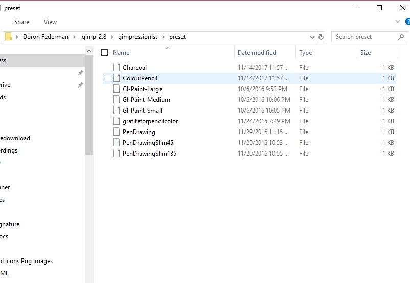

I Unzip the file.
But I have a new ERROR.
Doron.
PostPosted: Fri Nov 24, 2017 6:54 am  (#4)
Did you download/install the reqd GI presets?
viewtopic.php?f=9&t=14962&start=0&hilit=Repository+Special+Editions+dinasset%27s+filters

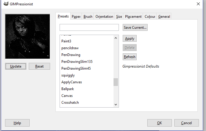

If you are in trouble please post a snapshot of your:
Gimpressionist
-Presets (list of content)
PostPosted: Fri Nov 24, 2017 8:29 am  (#13)
Joined: Mar 06, 2015
Posts: 308
Gimpressionist
This is the PIC of my Presets Folder.
I have Error in this Effect " DIEGO_ARTISTIC_CrazyHedcutSE.py "
I add the Effect " DIEGO_ARTISTIC_CrazyHedcut.py "
And this effect work fine.
Doron.
PostPosted: Fri Nov 24, 2017 8:38 am  (#14)
Well, the version without the suffix SE does not use Gimpressionist, it uses G'MIC.
The version suffixed SE uses Gimpressionist.
IMHO the error is in the "preset" folder name, it should be named "Presets".
You may give another try after renaming

BTW, can you use Gimpressionist standalone?
If not, that confirms that it requires the folder named Presets
Posts: 308
Thanks
I will rename the folder.
Doron.
PostPosted: Fri Nov 24, 2017 8:49 am  (#17)
Posts: 308
I rename the folder and it is O.K
Thanks Thanks Thanks Thanks
