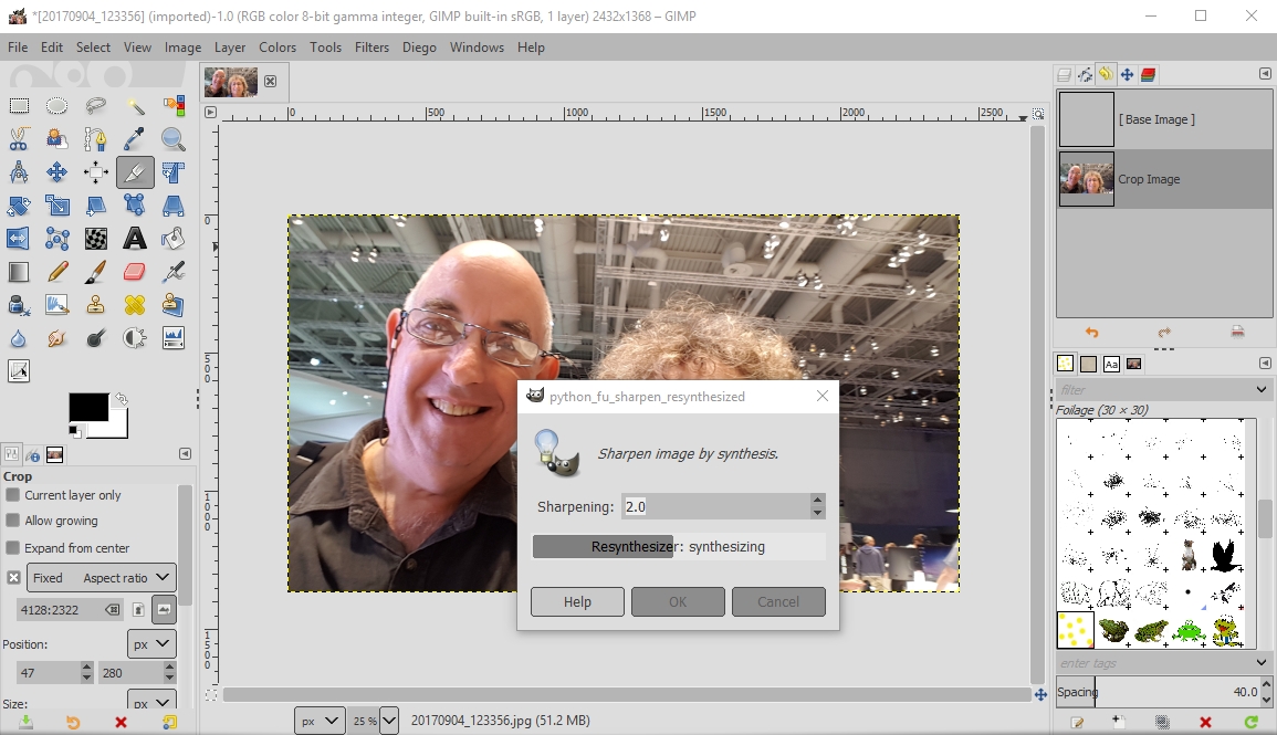

Hi gimp users
I run the effect - Sharpen with Resynthesized.
It takes a lot of time, a lot of time, a lot of time, ...........
Is there any solution to the problem?
Doron.

Unfortunately, no. It is a very slow script since it relies on Resynthesiser and your results will be mixed as well. I recently used this method for a deep dream render fyi (a few other things too for cleanup). :)

I tend to agree with Lyle.
However,
the size/dimensions of a given image,
also has an effect on how long it takes to complete.
Scaling the image down to a more appropriate dimension,
for the photo's intended use.
Could help to have it work quicker.
This script seems to work on a 1 to 1 pixel basis.
Less pixels my,
in most cases,
equate to faster completion times.

I tried this and size does matter. Smaller sizes require less time to process. The quality sucks pretty bad however. I don't know why the need for such a filter???
