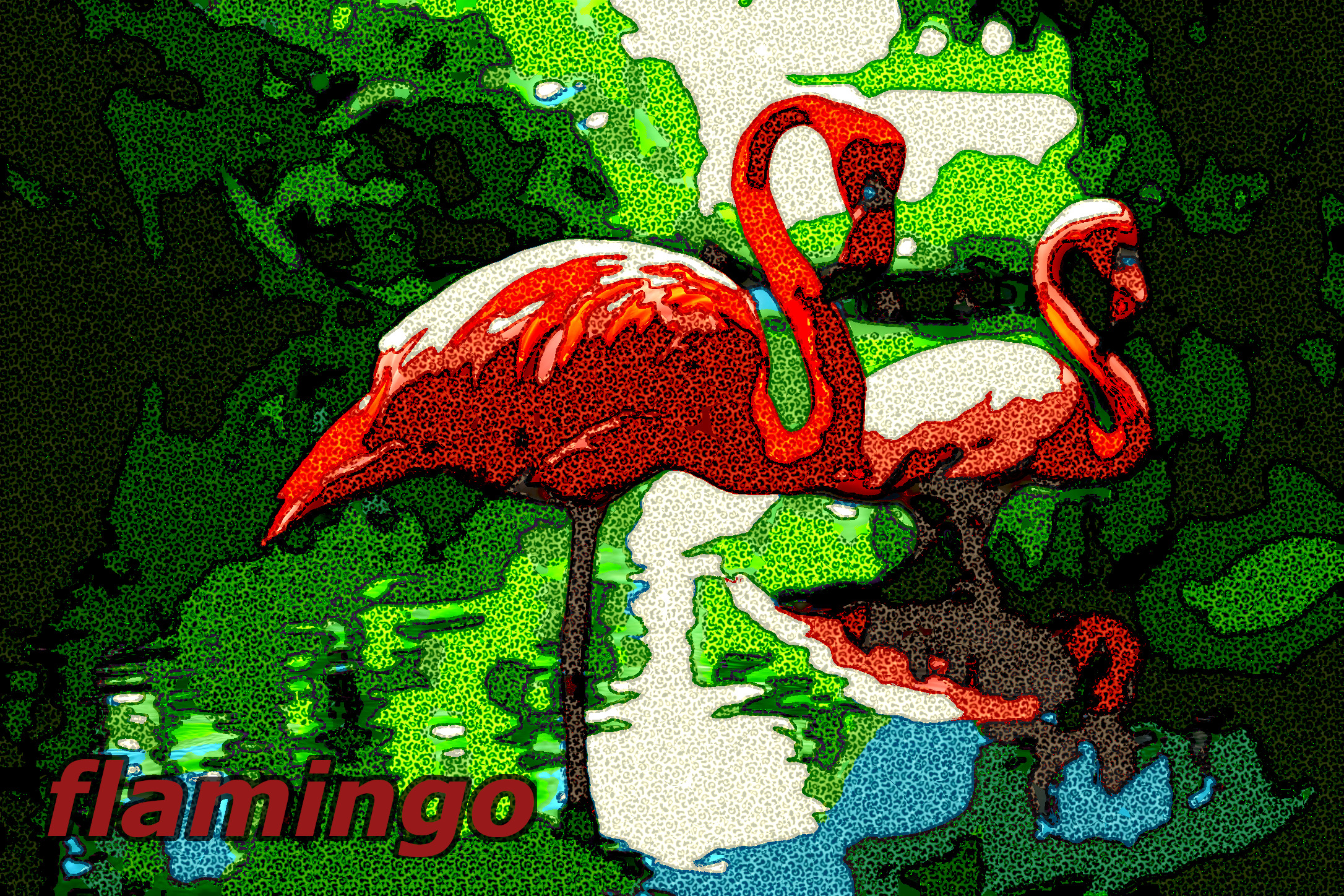

PostPosted: Mon Jul 02, 2018 2:02 am  (#2)
Something similar can be obtained by:
- write your text
- duplicate
- on the layer below the top (i.e. the second text layer) select the text area
- grow it by a certain number of pixels
- fill it with a dark gray, mode multiply
Did you try it?

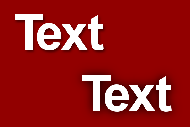

PostPosted: Mon Jul 02, 2018 2:38 am  (#3)
Joined: Sep 20, 2016
Posts: 293
Your description sounds like you are bluring a black copy of the text, or, alternatively, grow a selection and feather. (text 2)
It could also be a dropshadow. (text 1)
