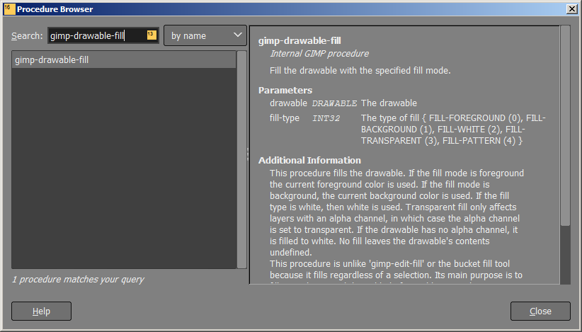

Open the script in a text editor and find WHITE-IMAGE-FILL
        (gimp-drawable-fill old-selection WHITE-IMAGE-FILL))
Now we know it's being passed to the function gimp-drawable-fill, so look that up in the Procedure Browser: Help >> Procedure Browser
Where we can see that acceptable values for the fill-type include FILL-WHITE
So I suggest changing WHITE-IMAGE-FILL to FILL-WHITE
