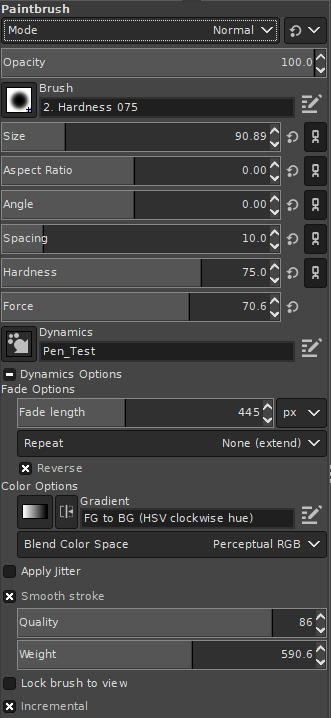

This is what my brush tool settings looked like at the time:

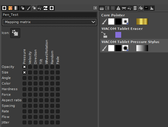

And this was the setting for the brush dynamics matrix (note the Wacom Tablet Pressure Stylus has the input focus highlighted):

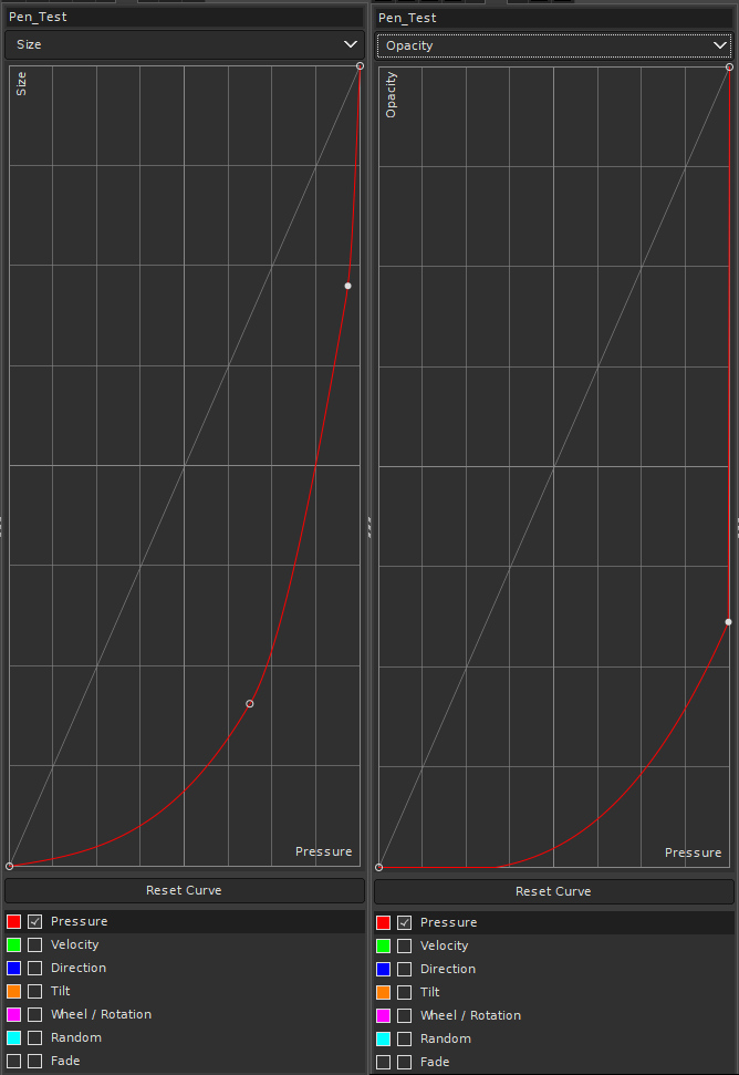

The settings that I had to play about with were the individual curve mappings for each property in the matrix. As you can see the opacity curve, in particular, was quite a dramatic change from the default setting.
Perhaps changes to these settings may provide some help - but, as I said earlier, I do think you may well have to update your version of Gimp.
