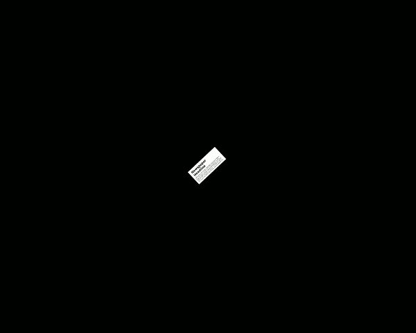

Tin, that is really neat! Any way to make it start very small, get large as spins, and stop for a second?
 Post subject: Re: Animation Automation
PostPosted: Wed Aug 08, 2018 11:02 pm  (#7)
Posts: 4554
Pat,
Please see this response here: https://www.gimplearn.net/viewtopic.php ... 525#p19525
which produces a result like this:

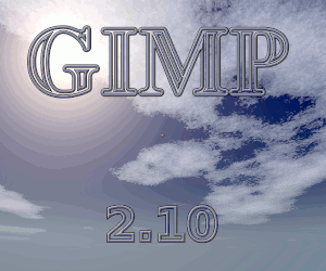

In another thread:
Question about Run Code on "Visible" ("now not only") Layers Script for GIMP - do you plan a version for groups of layers
Run code:
https://www.gimplearn.net/viewtopic.php/GIMP-Python-Fu-Scripts-Plug-ins/Run-Code-on-Visible-Layers-Script-for-GIMP?f=3&t=1027
Remove Alpha on all layers
http://gimpchat.com/viewtopic.php?f=9&t=16743&sid=49bc8bcca5991ab1c3067ae280e5cbdf#p230356
Hi Tas_mania
What MathMap plugins do you write that do not work for Windows?
A small attempt in Windows Vista 32 bit, GimpEval 2.10.5 compiled by Samj - but removed (a great shame for users of old laptops 32 bit) and replaced by the official version 2.10.4 (which requires a minimum of Window7).
