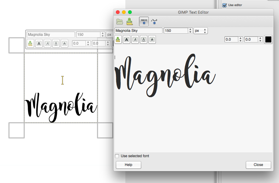

Can anyone please explain to me why this particular font just isn't working properly? The top of letters are being chopped off, despite it looking whole in Text Editor. I've tried adjusting everything I can think of with no luck. This font works perfectly fine in Illustrator - but I use Gimp more than AI and would really like to get it working properly! :)

If you do Layer>Text to path, is the path complete or is it also missing the top? And does it extends beyond the boundaries of the text layer?

It's within the boundaries of the text layer. Fit canvas to layers didn't seem to help. The path is complete though, which at least gives me a (albeit annoying) workaround for now :) Thanks graechan & ofnuts

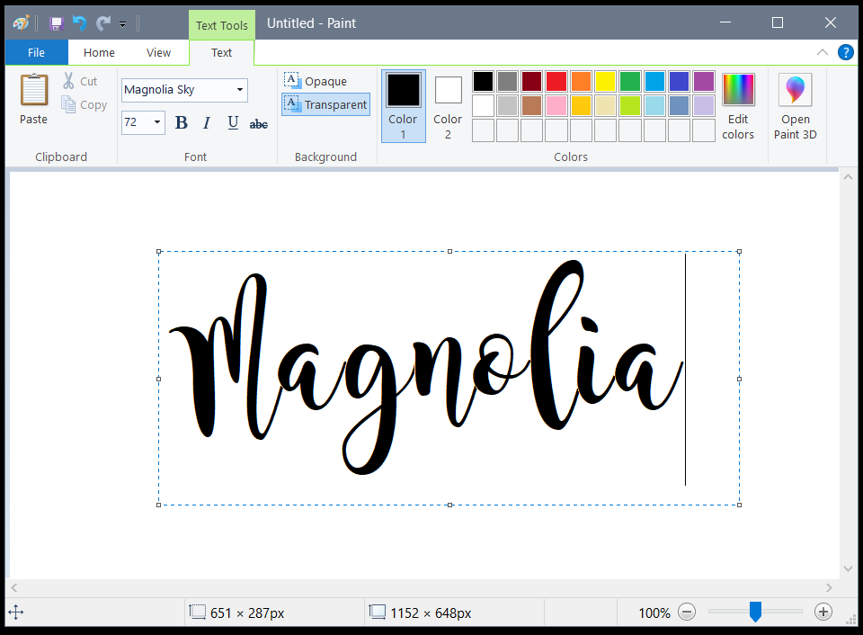

Note,
that this font is not cut off,
when used in MS Paint.

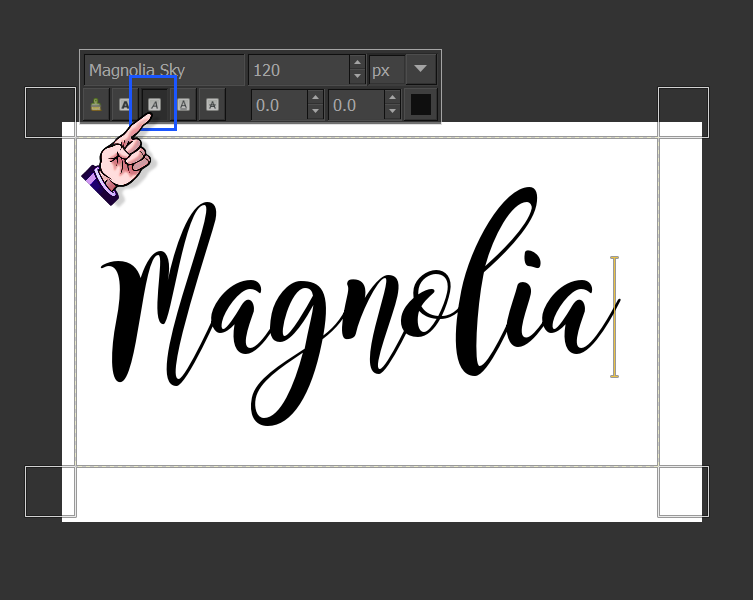

Here's this font in GIMP,
with Italic selected.
From within GIMP's onscreen text editor.
Look no cut off parts.

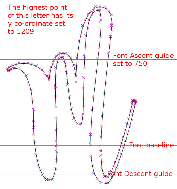

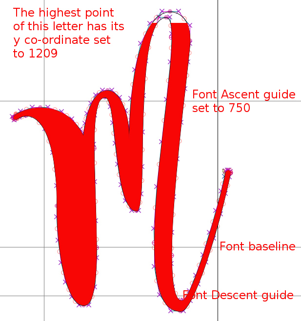

charmina I think you're just unlucky with your font choice in Gimp.
A quick inspection of the font in Font Forge shows that the author has placed the topmost control points of the offending letters outside Gimp's text rendering comfort zone.
The font was designed with the standard Em size (for ttf fonts) of 1000 and within that the ascender height was set to 750 (think capital letter height) - the default size for many fonts. The y co-ordinate of the top-most control point for the capital letter M has been set to 1209 by the author - a fair way above that 750 value.
Gimp does allow for quite a bit of wiggle room to render fonts - other programs may allow more space - but not quite enough for this particular font. The attchments below show you that Gimp is almost (but sadly not) there.
Your options as far as I can tell: Choose another font; email the author for a new version; try another graphics application and import it into Gimp...
Font Forge view of capital M control points:
Same view with capital M added so you can see where Gimp's rendering almost makes it.

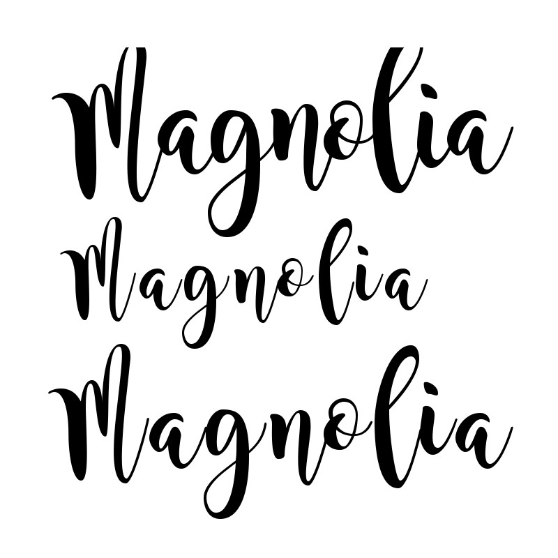

Got to the same place in fontforge yesterday , but apart from scaling it could end up a lot of work and I am no expert when it comes to fontforge. This is it scaled 65%
The original (top) Magnolia Sky @ 150 pix
becomes (middle) gimp-magnolia-sky @ 150 pix note how the kerning is broken. The letters do not join together.
A bit of adjustment in Gimp (bottom) 200 pix and kerning set to -5 or -6. You could improve it a little more by selecting and adjusting individual characters, depends how keen you are.
I go with skinnyhouse, email the font author.
Font (zipped) attached as an example. shows up as gimp-magnolia.

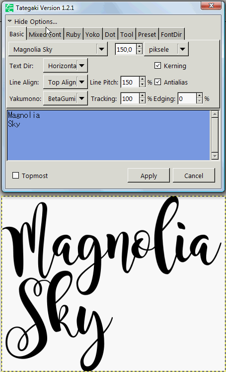

Thanks for the valuable information from Skinnyhouse and Rich2005.
But why is not this problem using Freetype or Tategaki-1.2.1 (http://reddog.s35.xrea.com/wiki/GIMP%E3%81%A7%E7%B8%A6%E6%9B%B8%E3%81%8D.html)?

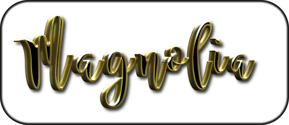

'Gimp-Magnolia-Sky' seems to work OK in scripts
This is from 'Black Gold' :bigthup
 Post subject: Re: Top of font cut off
PostPosted: Thu Jan 04, 2018 2:19 am  (#16)
Posts: 14237
The font looks great in Black Gold. Good! thanks Graechan.
