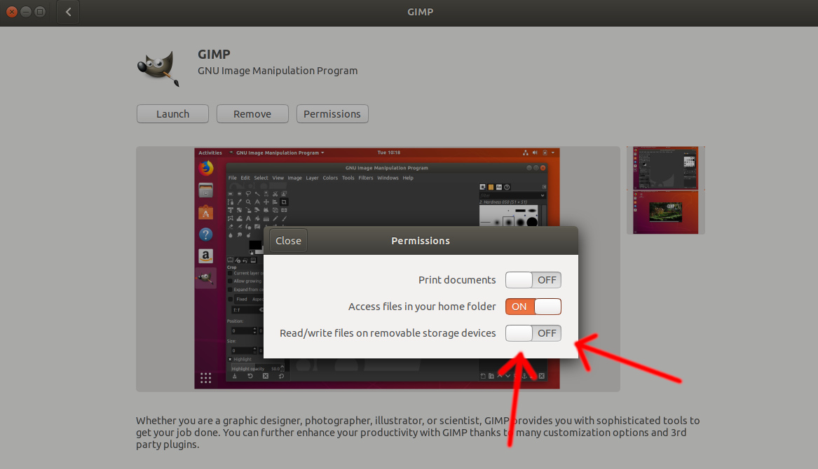

Hmm... In the Ubuntu Software “manager”, on Gimp's own “page”, there is a special button called “Permissions”. In the list of permissions it serves you, the last one seems to potentially give you the problem I've had up until now. (See pic.) This seems to be the culprit. I've managed to enter the data disk now. <phew!>
File comment: The culprit.
 Post subject: Re: Gimp access to /media directory (Ubuntu)
PostPosted: Mon Sep 10, 2018 7:21 pm  (#8)
Posts: 4500
nice find
TinT
PostPosted: Mon Sep 10, 2018 7:25 pm  (#9)
Posts: 4500
I don't know how to get to see whatyou're seeing though. I used the flatpak installation for GIMP so i run gimp from command line
