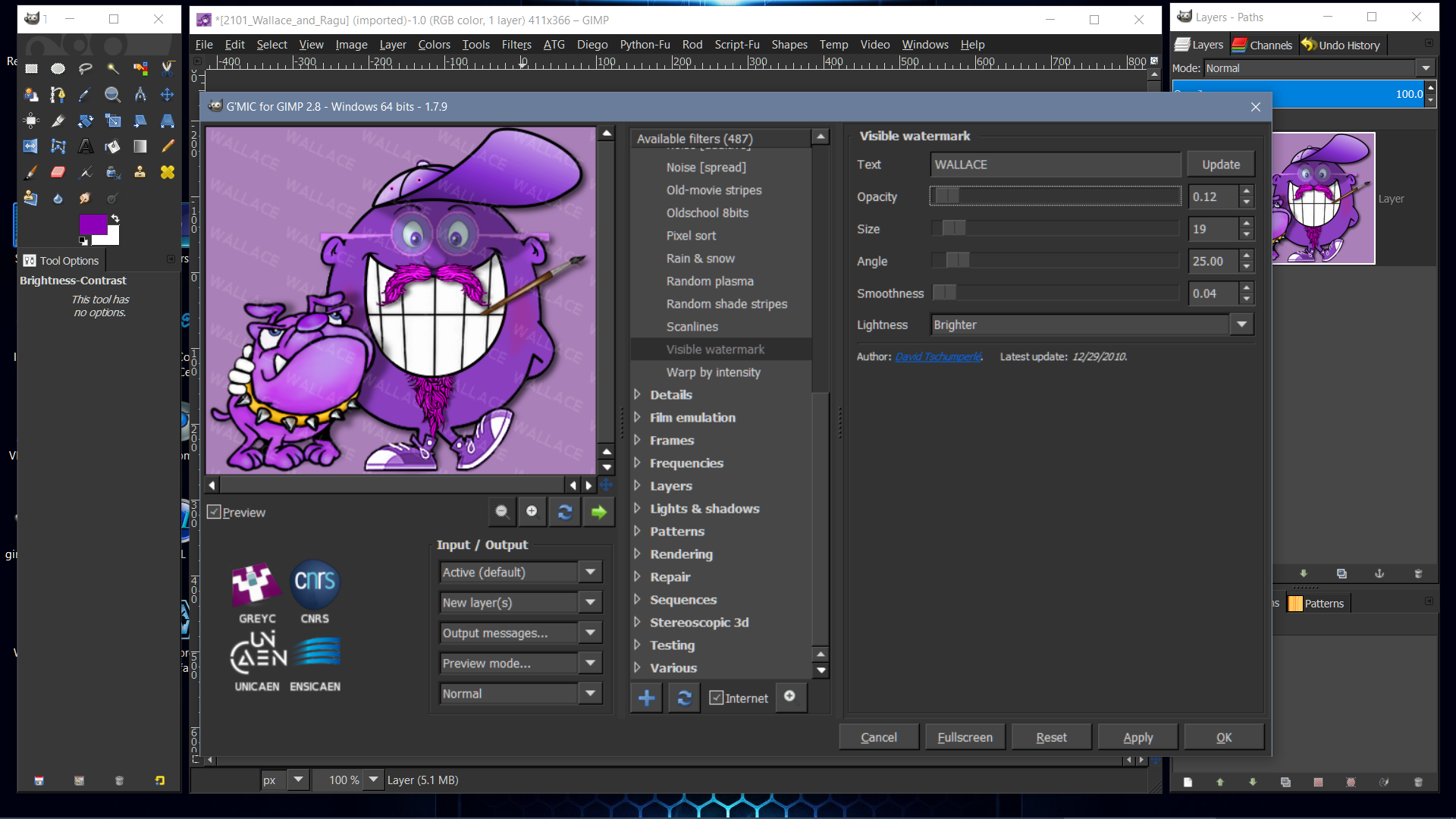

Posts: 14268
mackenzieh wrote:
I posted my signature (which was probably not smart) in order to know how to turn it into a watermark in the easiest yet cleanest way possible. I think I've found a way might be even simpler. I saw a video where someone created a brush using their signature, so I might try that method.
There is a filter in G'Mic called Visible Watermark.
It's under Degradations >Visible Watermark.
It looks like this.

Wallace wrote:
It look like this.
I hadn't noticed that filter, in G'Mic. Thanks Wallace. I will definitely try that out.
