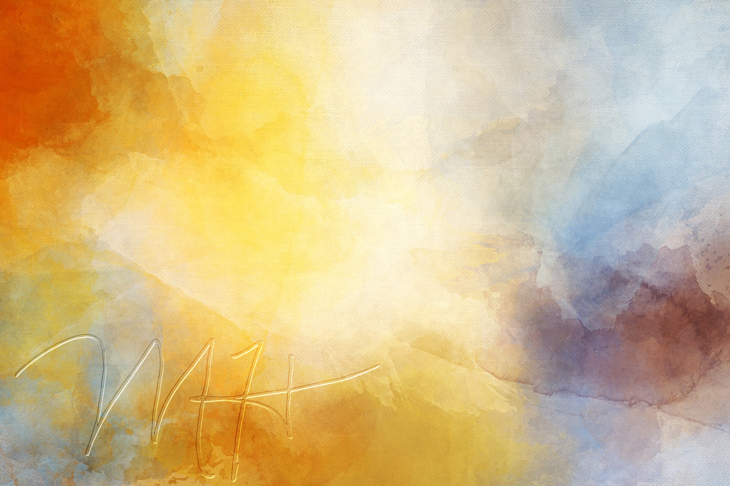

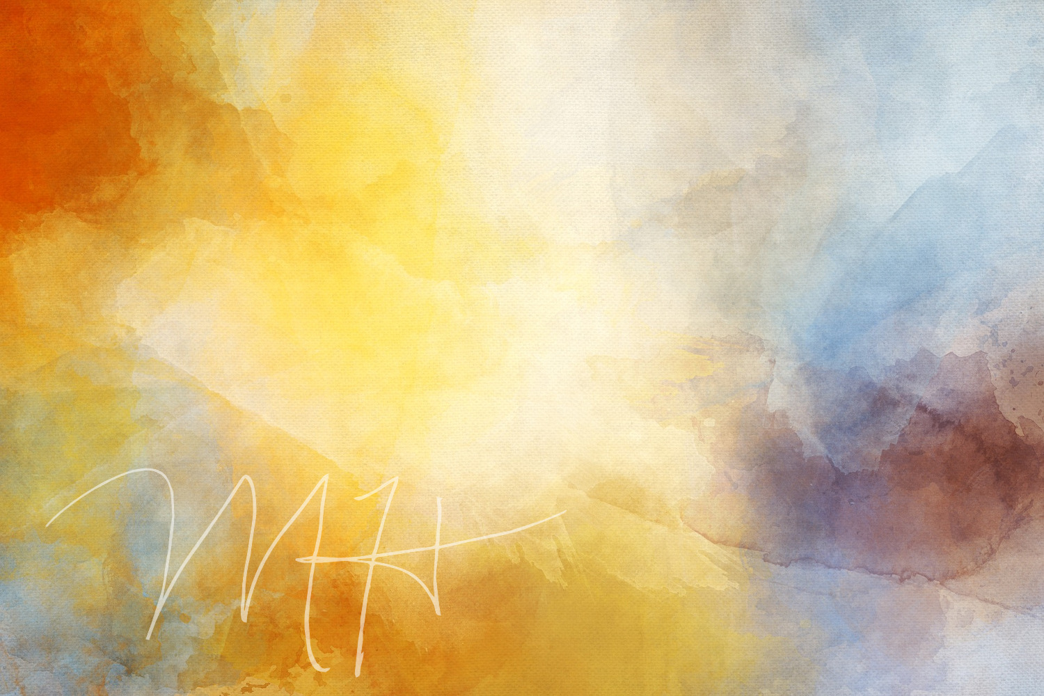

mackenzieh, is it something like this you want ?

With the color picker I selected the background color.
Then I did alpha to color so the only thing left was the handwriting.
That I turned into a path.
The path wasn't very clear so I cleaned it up a bit and for the first part of the letter M I used the path drawing tool to make it more visible.
Afterwards I filed the path on a new layer.
The first example is an embossed one. That I made with this tutorial.
https://www.youtube.com/watch?v=n4OBn5DJdjk
The second one is white with a lowered opacity.
