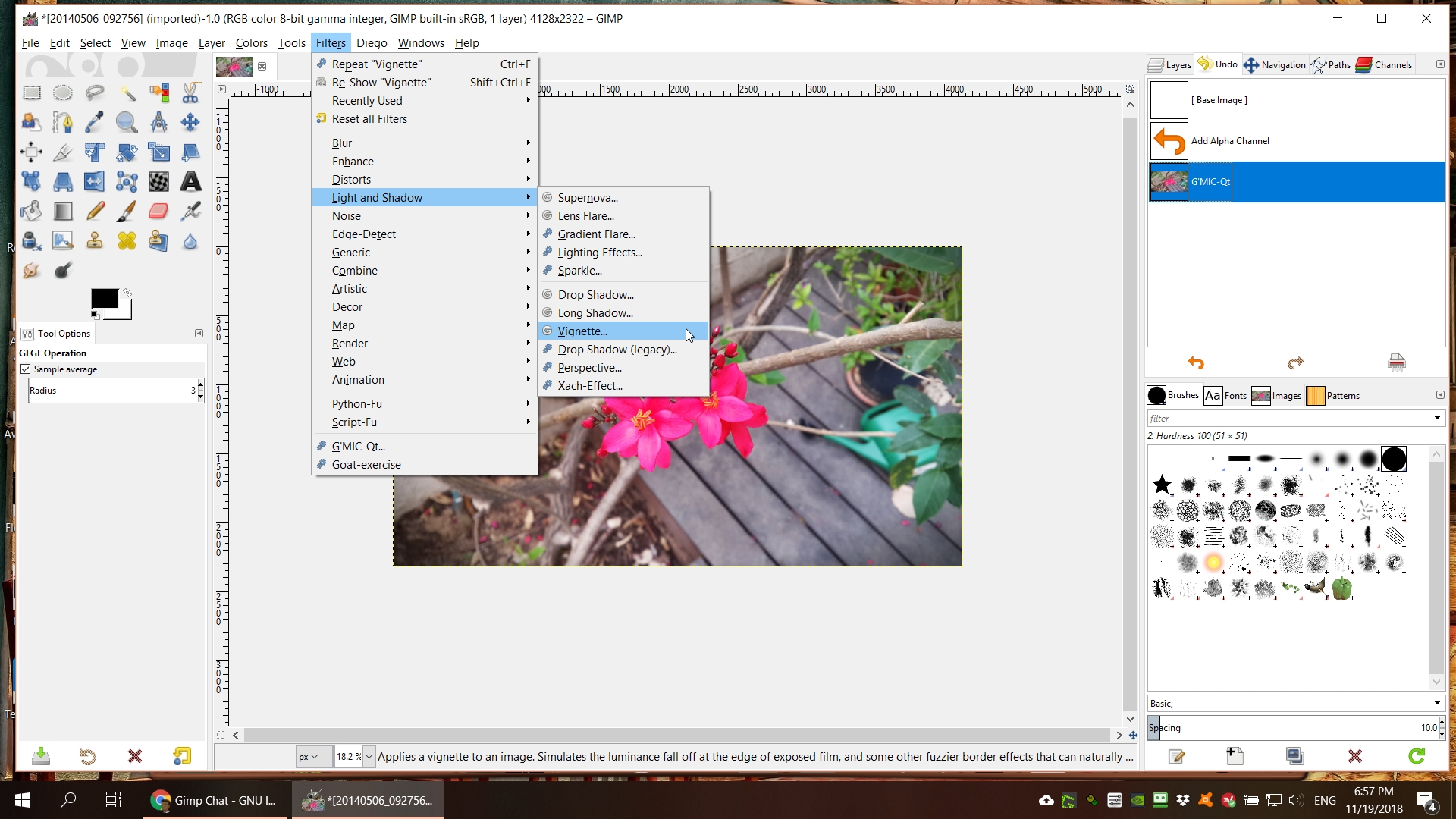

Hi Gimp user
There is the Vignette effect inside the filters of the software.
Filters -> Light and shadows -> Vignette.
See attached picture.
Doron.

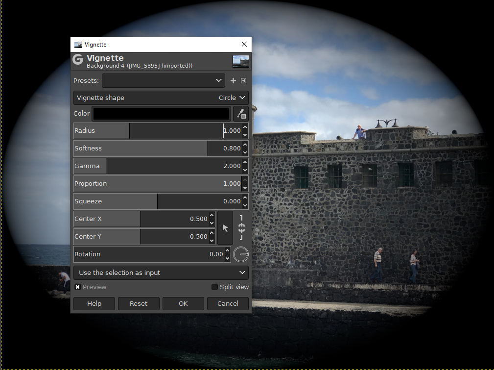

The function mentioned by Doron is not a script, is a native GEGL function, and the parameter used to create the area of the vignette is (mainly) the radius.

Also, tried GEGL Vignette with a selection: it works fine IMO.
