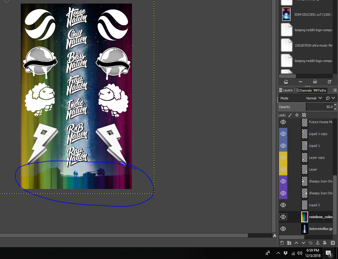

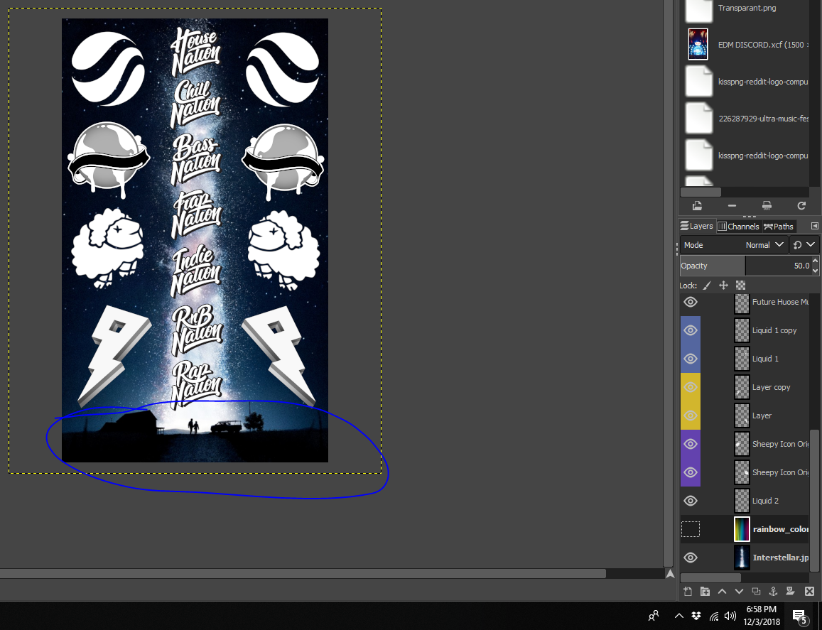

Hello, I'm trying to get part of the ground to cover this color background. In other worlds just trying to get the color layer viewed in the background and the ground is just black.
imgur(dot)com/gallery/xnjAtTv
What are the methods I can do to have the ground appear on top, or cut out the bottom part of the color layer?
