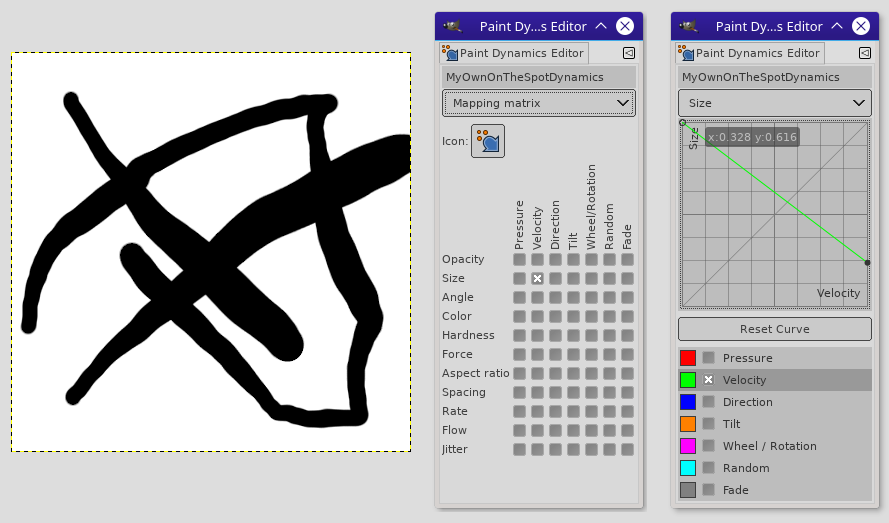

I've just been reading about dynamic settings for brushes....in gimp docs/2.8/3.2 Dynamics, it says:
"You may for instance let the width of the pencil vary according to the speed of the stylus or the mouse"
Can this also be done in 2.10?....
I'm using a mouse for input but don't seem to be having any luck getting any varing width, its just the same width from top to bottom; even when I have it set to Dynamics, Pressure or Opacity size....or am I using the wrong dynamic?
Any ideas for settings I should use?
Many Thanks,
 Post subject: Re: A Brush Settings Question
PostPosted: Tue Apr 02, 2019 2:32 pm  (#2)
Make your own Dynamics:

.... :tyspin very much ofnuts....that did the trick....
