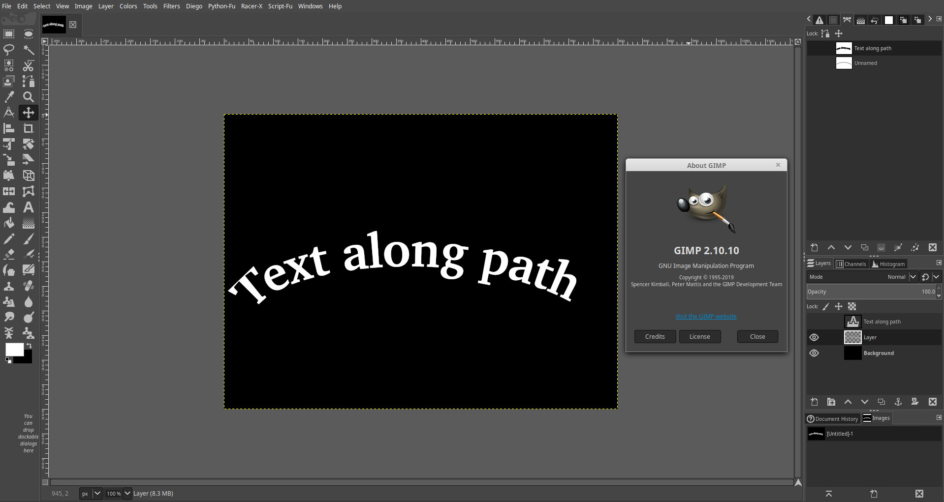

 Post subject: Re: PPA's, Plugin's, Linux Mint, and Gimp
PostPosted: Thu Apr 25, 2019 5:17 pm  (#5)
Text along path works fine in Gimp 2.10.10 AppImage, So I'm guessing Rich2005 is correct.
