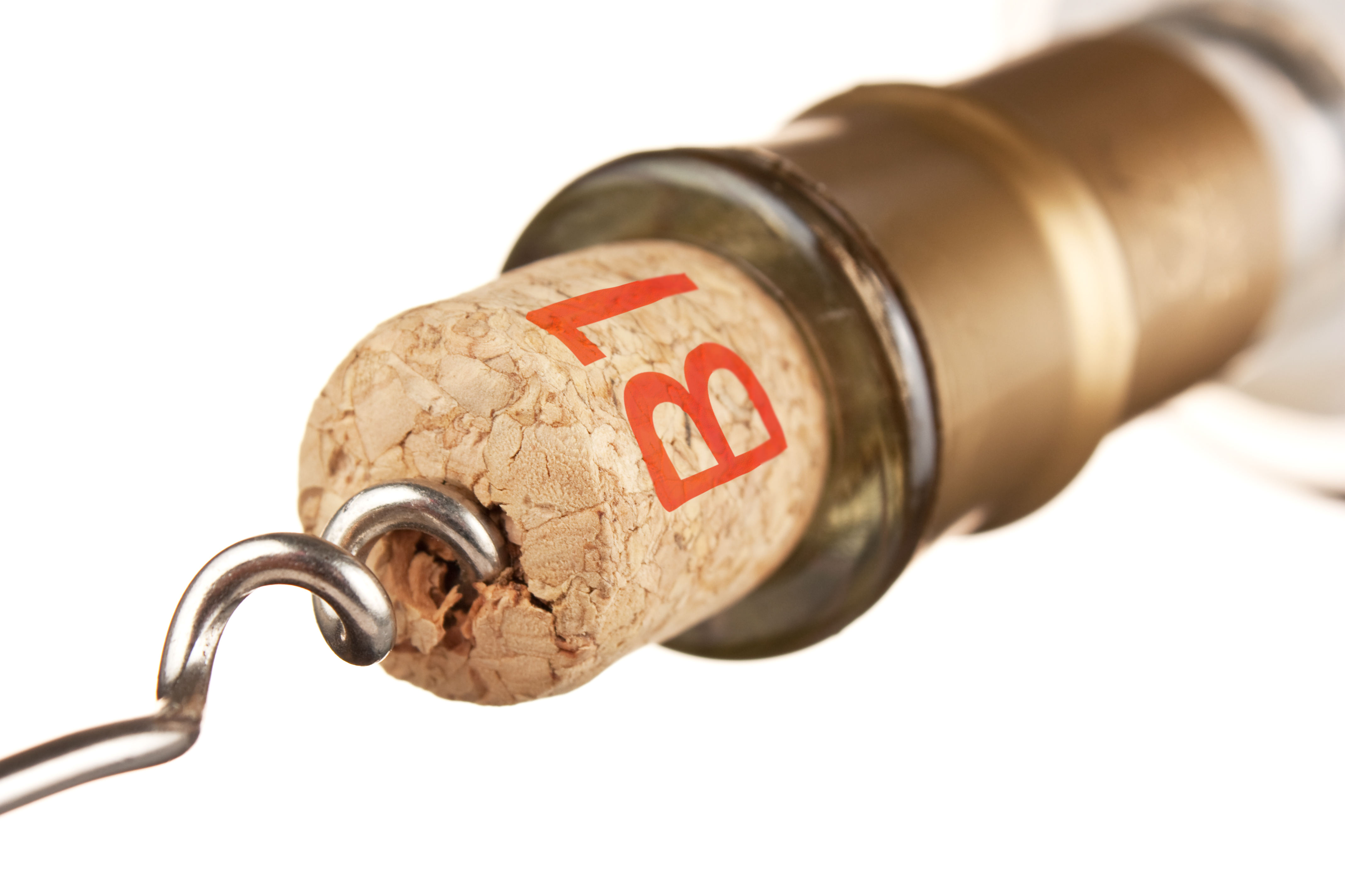

What I want is of the text to look like it is printed on the cork

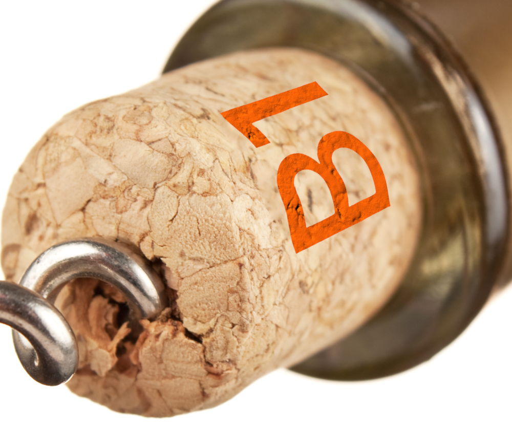

I have used a simpler, quicker method here.
1) Give the text layer a slight curve using the Warp Transfrom tool.
https://docs.gimp.org/2.10/en/gimp-tool-warp.html
2) Bump map the text. Use the cork layer as the pattern (Aux Input).
(Use "Layer > Layer to Image Size" before bump mapping.
https://docs.gimp.org/2.8/en/plug-in-bump-map.html

Awesome! Annoyingly quick! Thanks. I will get on it. That's what I am going for.

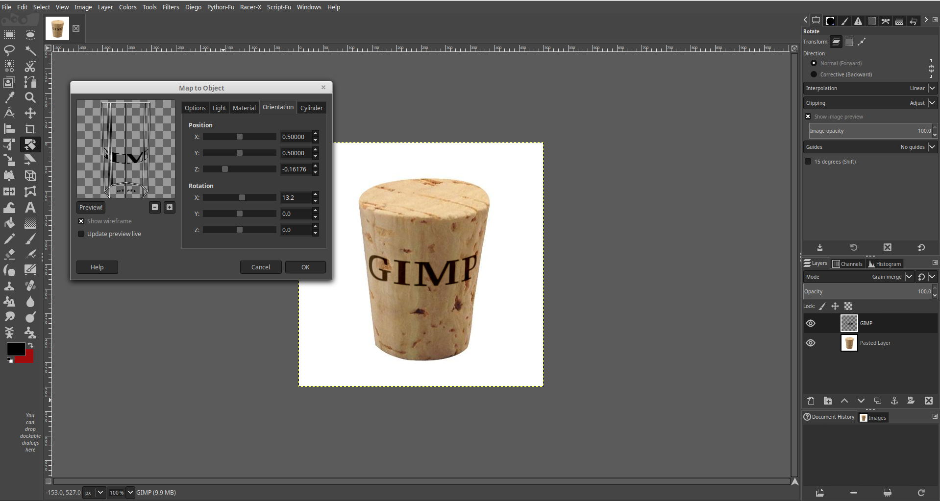

Agree with rich2005. Map Object using cylinder is what you want. Overlay using "Grain Merge" blending mode.
