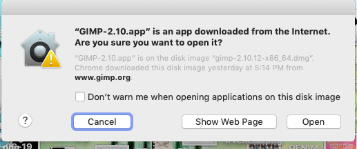

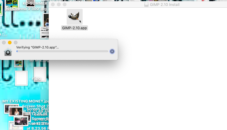

Thank you for your answer. I've been through some of the events described on Reddit when I've first installed Gimp, the previous version.
Actually now is going through the last step but is not showing the screen and bars to start working. At the last step I hit Open (is already configured for "App store and trusted developers").
Gimp is in Macintosh HD - Applications; this is the place where I've started when opening the application.

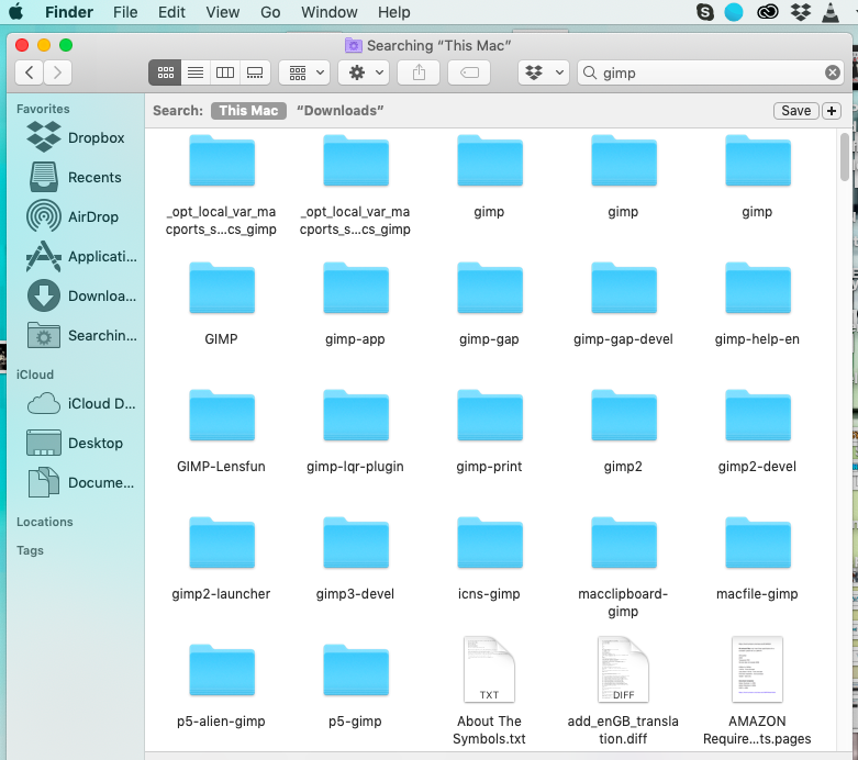

I've took pictures for each step to be more clear in what I want to say.
Because are aloud only 3 pic, I skip some steps and left the beginning and the last one.
