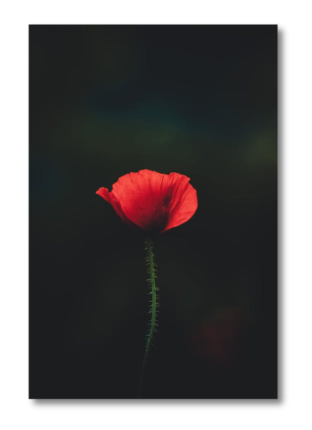

Do you mean something like this?

You need be sure the picture/image has space around it.
Like this.
Than try to run your Drop Shadow.
There are a number of ways to create a drop shadow.
Using the built in Drop Shadow filter is only one of the ways.
