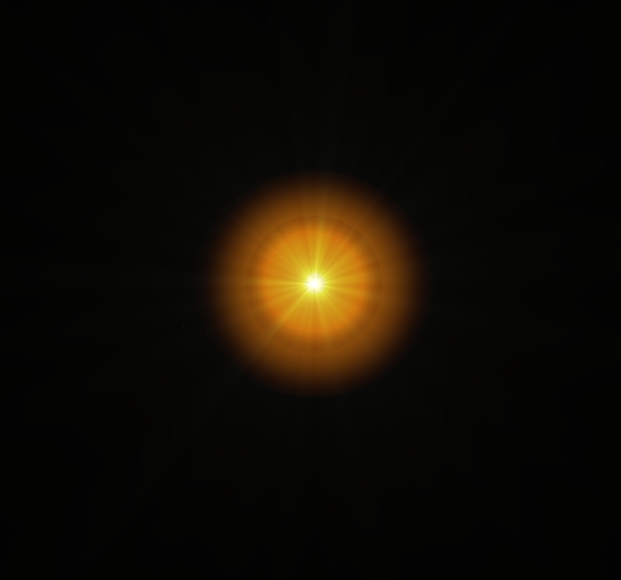

Hello everyone,
I would like to create something similar like in the attached image bellow. How can I create something like this?
I tried supernova and then blurring it but the rays were exceed way too far even in the lowest setting. I also tried radial gradients that also did not help much. I want the rays to be just enough long from the center I need the color change be as smooth as possible, no sharp edges.
Thanks.

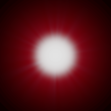

Maybe something like this?

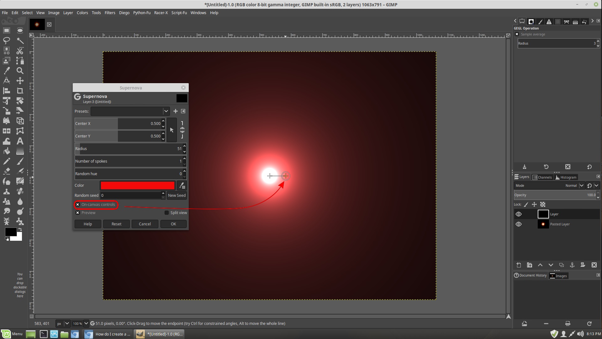

Two layers.
First Layer black, solid color
Second Layer on top:
Ellipse select tool, fixed ratio 1:1, feathered edges
Bucket fill tool, foreground color fill
Invert selection
Supernova tool, color red, oncanvas control on like racer-x shows, play around with radius and spikes
Ellipse select tool; Select -> feather at about 200 (play around a bit), Select -> invert, clear
Ellipse select again, invert selection
Gaussian blur
made this:
I guess if you play around with some layers and different colors for the supernova effect you'll get the desired effect.

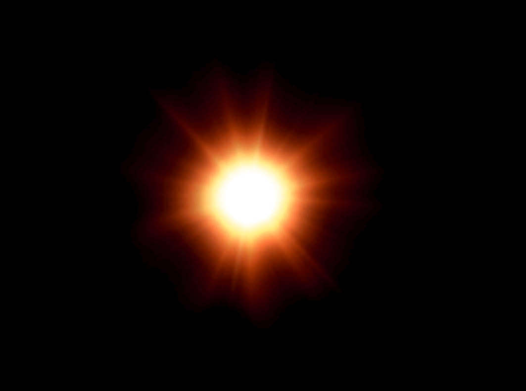

This is what I came up.
File comment: sunflare
