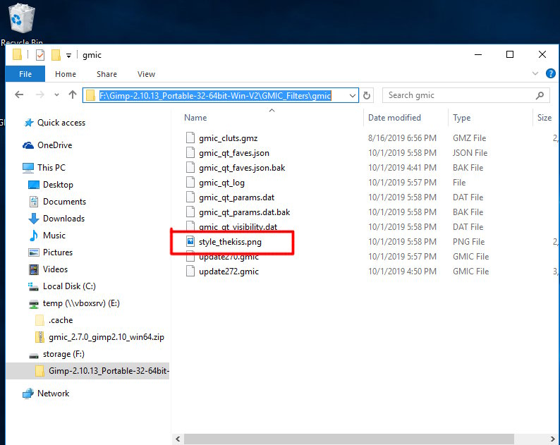

While gmic needs a connection if you use the the stylize dropdown menu, the image file style_some-name.png ends up in the gmic folder ...
for samj it is ...\GMIC_Filters\gmic
Regular Windows Gimp 2.10 ... C:\Users\"yourname"\AppData\Roaming\gmic
Linux ~/.cache/gmic
Not connected? You can use those files and add to your image as a layer then use the stylize Custom option.
rich2005Image
Yes I found the viewed images in: D: \ Gimp-2.10.13_Portable-32-64bit-Win-V2 \ GMIC_Filters \ gmic
